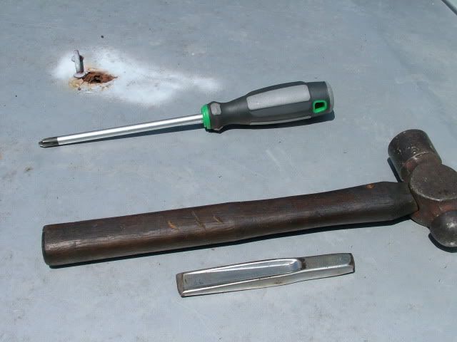

You will need: Hammer, Coldchisel, Large phillips head screwdriver.
Step 2:

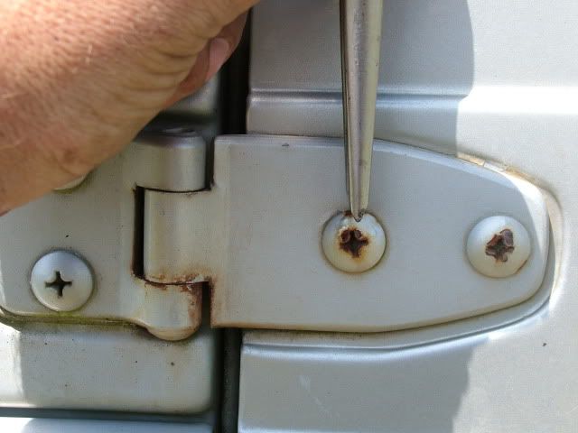

Place the coldchisel on the edge of the screw like shown below. Strike with hammer hard enough to put a notch in the screw.

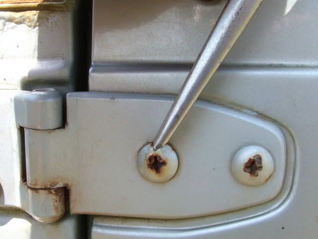

Keeping the tip of the chisel in the notch, lay it over a bit as shown. Undo is anti-clockwise so always lay it to the right when looking at the screw head.

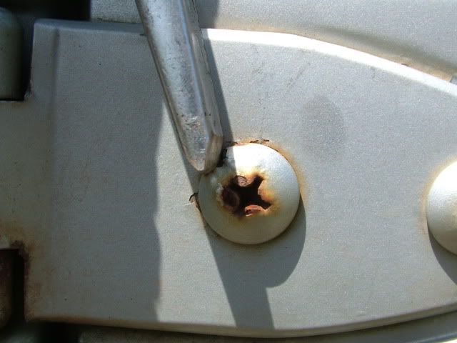

Strike again with hammer and screw will begin to rotate.

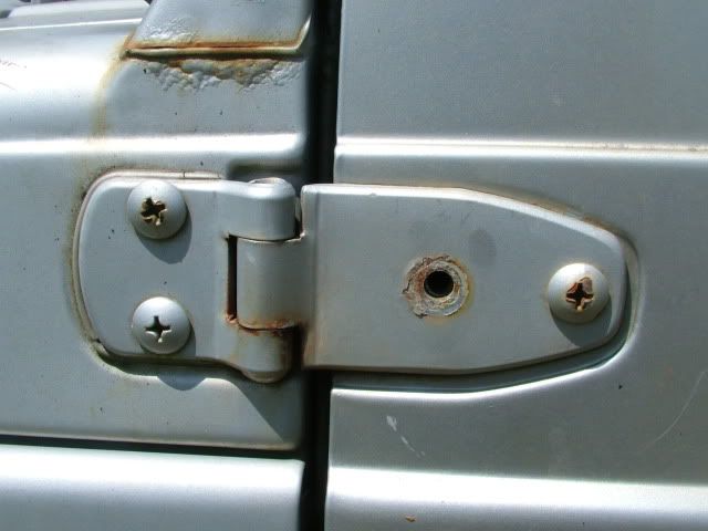

Remove screw with screwdriver.
Always use Coppertec or NevaSieze or similar when reinstalling these screws and removing them in future will only require a screwdriver.
Ideally they are best replaced with stainless button head capscrews.
