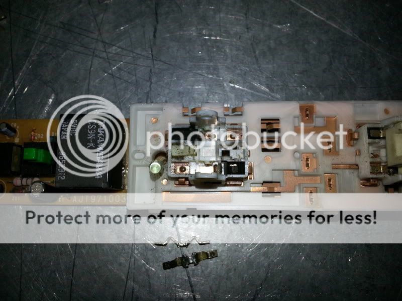

Here is how I went about fixing the dodgy drivers side power window switch in my Vitara. Firstly remove door trim & remove Window Switch. The drivers side switch would not wind down the passenger side window, but it would wind it up. :twisted:

then separate the top off the board
this is the passenger rocker switch
and the illuminated drivers rocker swtich
pop off the rocker
lift out the contact springs

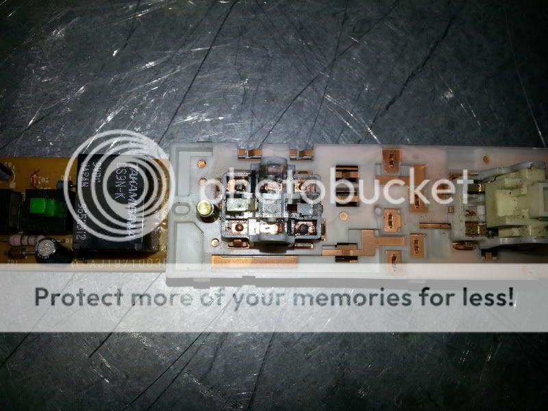

Showing the dirty contacts 8O
Now use a small piece of paper towel & the screw driver to clean the whole lot up, I scratched up the contact areas so they were all fresh metal.
clean up the spingy things
put the springs back in
put the rocker back in
grab you brothers toothbrush & some warm water & clean up all the buttons & platics.
line the tabs up for the central locking rocker
clip it all back together
Go outside & test.
All fixed... :wink:

Just did this again in the new car - windows would go down but not up:
Before:
Bit of contact cleaner and a bit of scratching around with a screwdriver covered in paper towel later:
Whole switch was covered in dust and crap. I don't think my door seals are working all that well any more...
