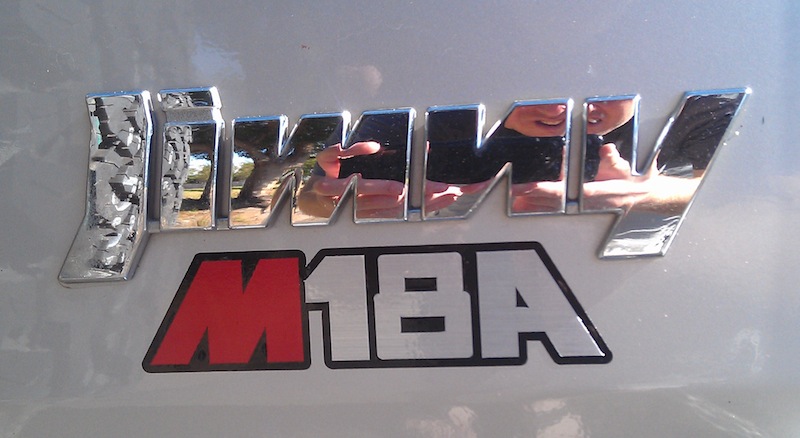

Post Posted: Thu Apr 17, 2014 3:55 pm
Soon we will need "M18A Crew" Stickers ;)
Post Posted: Thu Apr 17, 2014 4:41 pm
I've got mine:
Post Posted: Thu Apr 17, 2014 10:33 pm
Oh I forgot about those.
