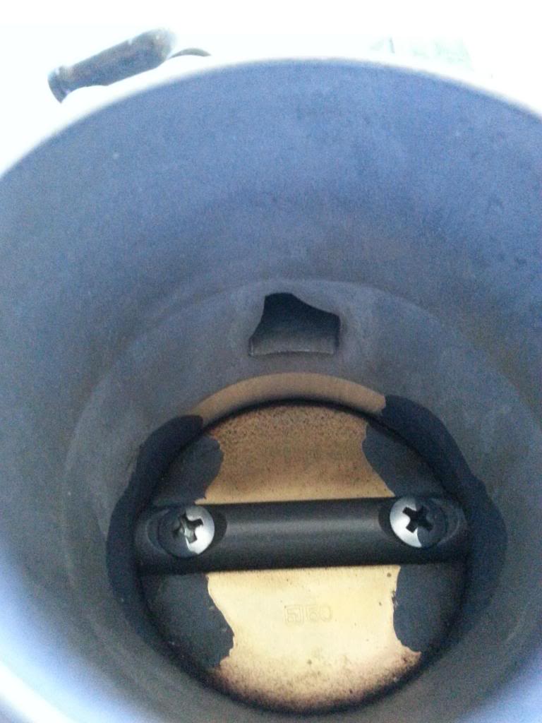

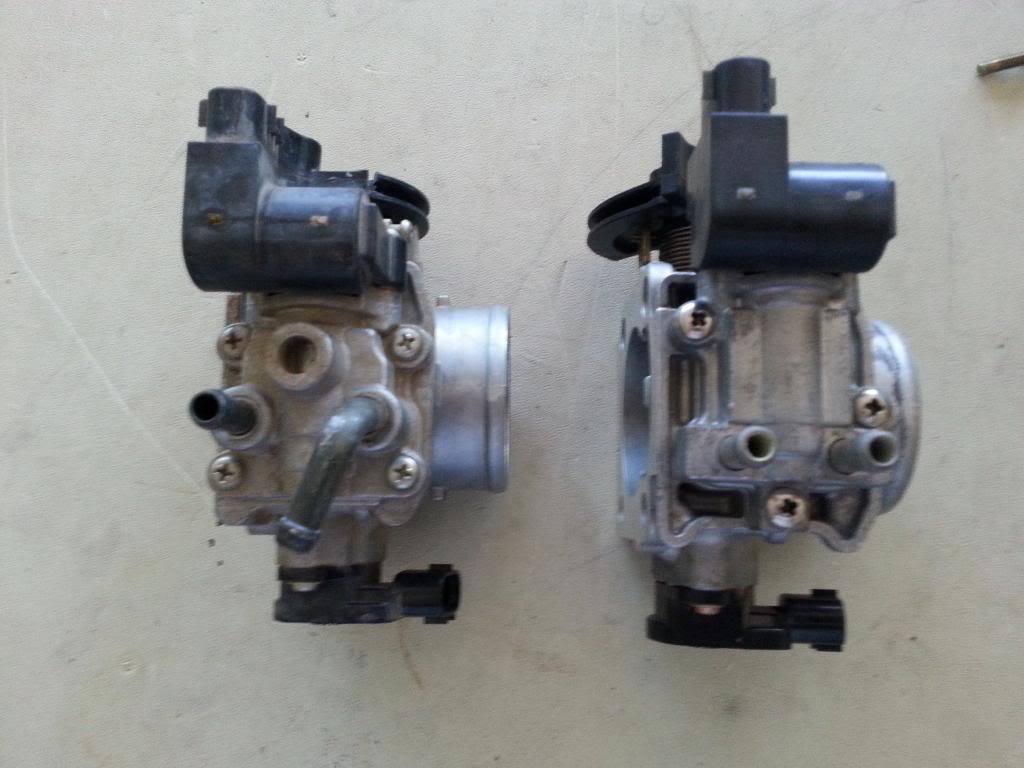

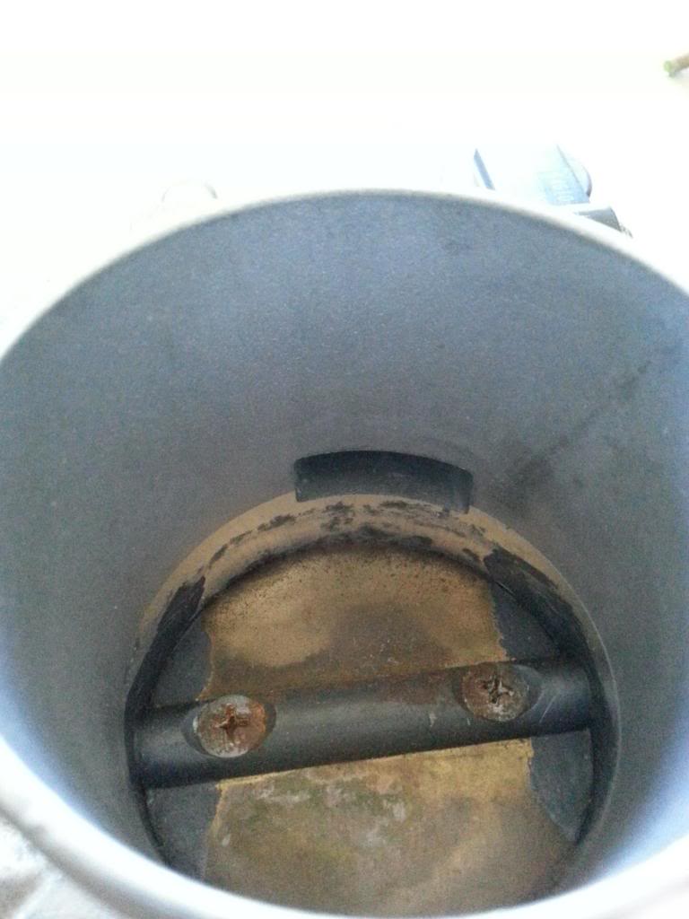

Post Posted: Sat Apr 12, 2014 9:54 pm
OK, so I had a look at using the 1.3 idle air control valve on the 1.8 throttle body today. As it turns out the idle air control valve is different shape on each throttle body as shown in this picture:
The 1.3 throttle body is on the left and the 1.8 is on the right. The idle air control valve on the 1.3 is held on with 4 bolts and on the 1.8 its held on with 3 bolts.
My first thought was to make up an adapter but then I realised that the port size is very different between the two.
1.3
1.8
So now I have a new plan. I am going to make a spacer/adapter that mounts the 1.8 idle air control valve to the 1.8 throttle body but has a smaller port opening in it. Hopefully this will let me use the 1.8 throttle body without the oscillating idle issue in the video above. Hopefully I can make up the adapter this week and then install it over the Easter weekend.

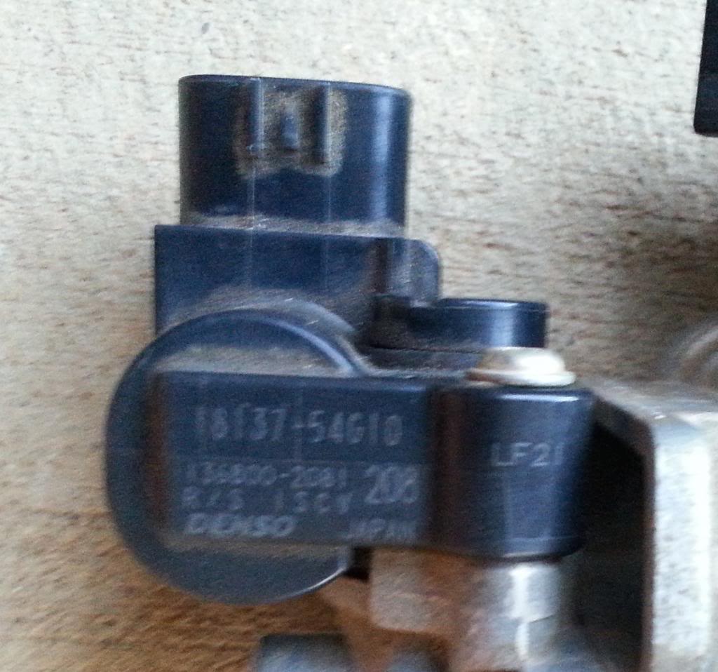

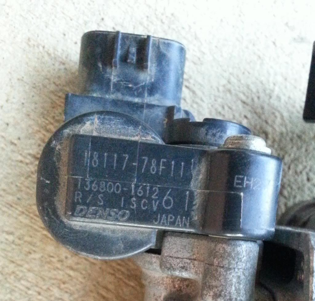

I installed the M18A throttle body today with the IAC motor (the black part of the IAC valve) from the M13A and so far every thing is working properly.
The IAC motor is held on with 2 #20 5 point torx screws. I didn't have a set of 5 point torx drivers so used it as an excuse to buy more tools.
The two IAC motors look exactly the same but have different part numbers. The IAC motor from the M13A is the one you want to use and it has 18117-78F11 written on it.
The M18A IAC motor has 18137-54G10 written on it.
The top coolant pipe on the M18A throttle body is different to the one on the M13A so you will have to use the top hose from the M18A as well. You can see the difference in this picture:
I've only driven a few kms since installing the bigger throttle body but the difference is fantastic. The engine feels so much more responsive now, it is clear that the engine was heavily restricted with the 1.3 throttle body (no big surprise really).
Thanks again to Bertie and Davesrt for pointing me in this direction, it's good to finally have a solution for using the 1.8 throttle body.
