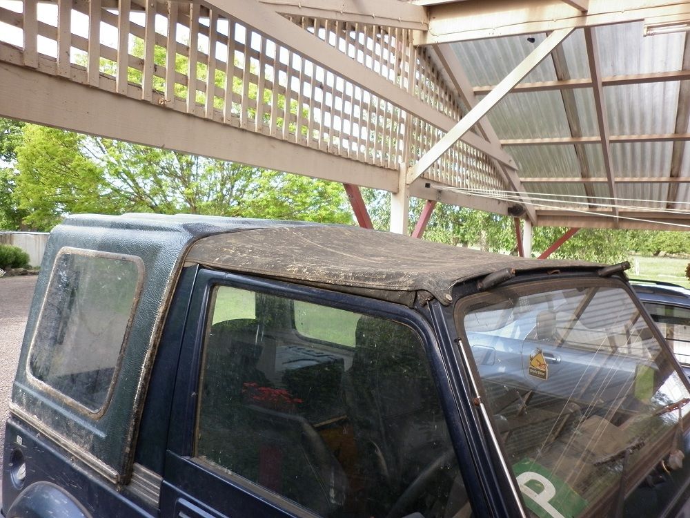

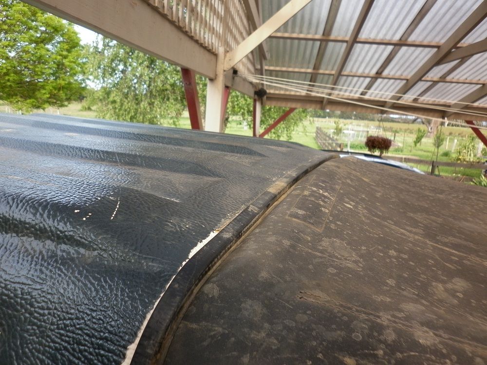

I bought a rear section flexiglass for the swb sierra the other day but soon found out that there isnt alot of front sections around,
i decided to cut down the soft top i had and hoped the rear section would hold it firmly to the B pillar
and from the short test drive at 100Kph it seems to work well, if it ends up not working then ill
wrap it around under the B pillar and stitch in back onto itself,
heres the pics,

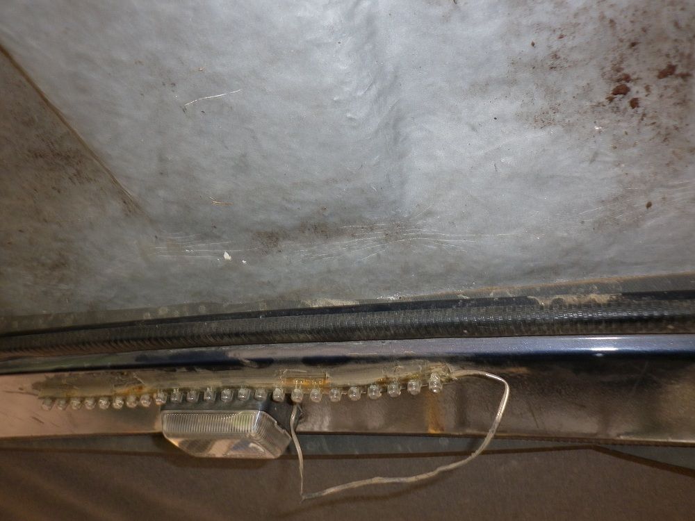

In the fold of the canvas behind the B pillar we put a peice of small rope that will hopefully stop it from
pulling back out from under the hardtop when it fills up wth water etc
