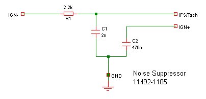

Post Posted: Mon Jun 18, 2012 7:08 pm
This is what I measured it as:

Post Posted: Mon Jun 18, 2012 7:48 pm
AWESOME thanks sooooooo much for that. Now lets hope that jaycar has those size capacitors and resistors :)

Post Posted: Mon Jun 18, 2012 9:05 pm
I forgot to mention that the coil negative is usually clamped at around 400V so you will need to ensure that your components are adequately rated. On the ign+ side you will see a lot of noise but 100V should be adequate.

Post Posted: Mon Jun 18, 2012 10:06 pm
So R1 and C1 need to be rated to 400v DC ??
bt50 now but still love the zooks
Posts: 686
Location: Brinkworth, England
Post Posted: Mon Jun 18, 2012 10:13 pm
Call it 500V and you should be good.

Post Posted: Mon Jun 18, 2012 10:48 pm
Thanks sooooo much for your help and the part number
I have had a look at a store here in oz and this is what i have found can you just check to make sure i have this right
.47uf 100Vdc
http://australia.rs-online.com/web/p/pl ... m/4762825/
2.2k resistor 500vdc
http://australia.rs-online.com/web/p/th ... d/0386240/
2200pf 500vdc
http://australia.rs-online.com/web/p/mica/0495896/

Posts: 686
Post Posted: Mon Jun 18, 2012 11:21 pm
You're OK on the tolerances as the stock items aren't so accurate, I wold go for a metal film resistor for reliability and you need a higher voltage rating anyway.

Have you checked with suzuki if the part is still available?
Joined: Mon Apr 13, 2009 11:30 pm
Posts: 1833
Vehicle: Sold zuk got a Bt50
Post Posted: Tue Jun 19, 2012 7:18 am
Yeah it is still available they have said it will be a special order and will take a minimum of a month to get here. have ordered one but It's the only thing left to do to start the car then get rego before I move back to Brisbane.
Post Posted: Tue Jun 19, 2012 9:52 am
gvzookdriver wrote:
have ordered one
How much they worth these days?
