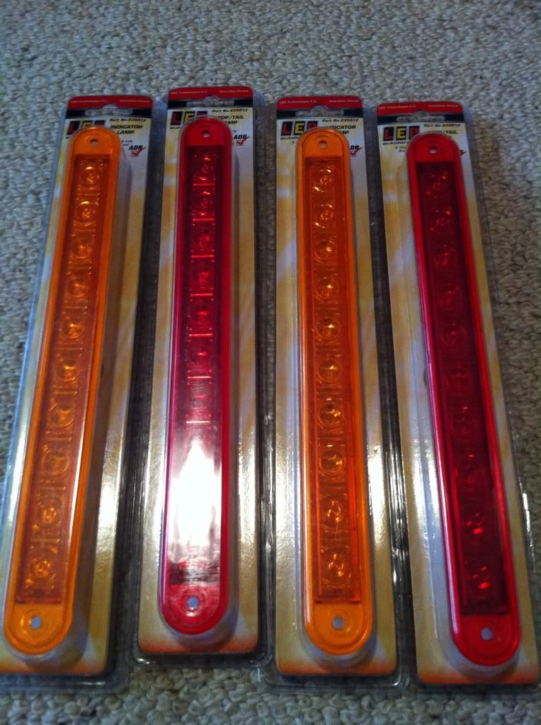

Post Posted: Fri Mar 16, 2012 8:40 am
I got 4 of these for $110 All ARD approved and they come in about 4 different length's i think (they also do a reverser light).

Post Posted: Fri Mar 16, 2012 5:54 pm
Who was that through monley? That's the style I'm after.

Post Posted: Fri Mar 16, 2012 11:05 pm
through supercheap, your price would be around 150 though
