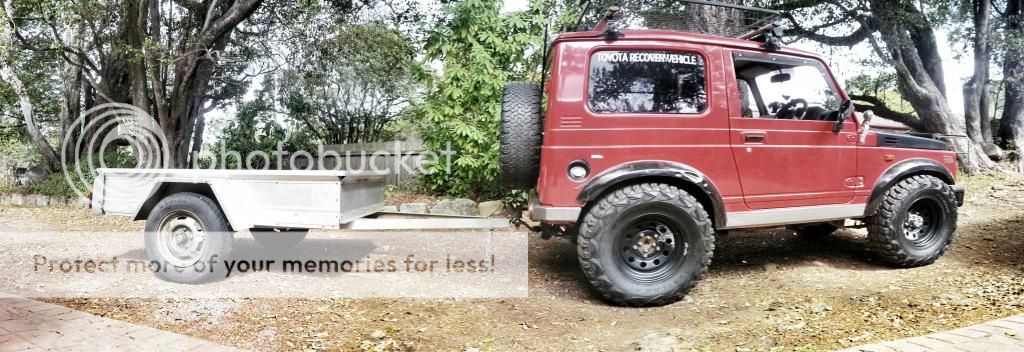

Hi Internet
I have built this trailer from an ikea pack. Made in 1982 finally assembled and modded by myself. ( 20 year old ) bad ass....
SO I want a real light weight Trailer for my sierra.
Upon collecting this kit from my miss' father. I was surprised with how cool this trailer is.
The bulk of this trailer is aluminum. After finishing building.
I weighed it..
130kg empty. Fuck yeah.
Tent is 40 somthing
So I hope to keep it under 200 kg (wishfull).
But will depend on how it tows.
Will load pics when I get to computer.
here is how it looks now
ImageJake

8O 130kgs Armsup is that with big wheels & tyres?
should be rules about starting a build thread & not posting pics in the first post. :wink:

pezz has given me inspiration....... might have bobbed it.
Posts: 5928
Post Posted: Sat Sep 13, 2014 4:32 am
That's cool. :)
