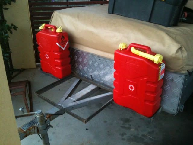

Have been wanting to carry the fridge and some fuel on the drawbar since I built the trailer. Off to moreton soon so no time like the present to get stuck in with the new gasless mig (my new favourite toy)
Post Posted: Sun Oct 24, 2010 9:19 am
Dont weld across the top of the drawbar!!!!!!!!
Post Posted: Sun Oct 24, 2010 9:26 am
Why not :?
Post Posted: Sun Oct 24, 2010 9:27 am
thats where is will snap :)
Post Posted: Sun Oct 24, 2010 9:31 am
Hows that :?
Post Posted: Sun Oct 24, 2010 9:34 am
Joe wrote:
Hows that :?
It causes a stress point. Only weld lengthways along the drawbar. Never across it.
Post Posted: Sun Oct 24, 2010 9:38 am
Draw bar is way stronger than necessary. I'll go easy on the welds.
Not across sounds like good advice

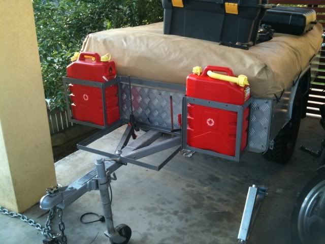

Post Posted: Wed Oct 27, 2010 9:12 am
The finished frame. Just got to sheet the front of the gerry can holders and make a box for the fridge.
Next up is the mounts to hang the water tank underneath.

You'll want something in front of the fridge to protect it from rock spray. Guarantee you'll end up with dents or a wrecked cover otherwise. Plastic jerries should be fine - mine have done several hundred kay's on dirt roads in a similar position on mine with no dramas.
Looking good - nice work! :)
Post Posted: Thu Oct 28, 2010 7:44 pm
I'm yet to make a slip on box which will double as a stand for the fridge while camping. The Gerrys will have a sheet of ply that will fold up as a small table and the rest of the time be a facade for protection.

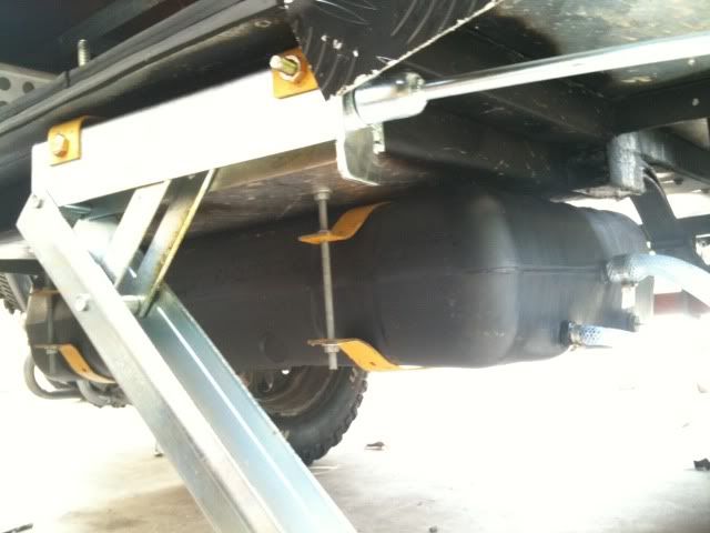

Post Posted: Mon Nov 01, 2010 2:26 am
Have finished mounting the water tank and rear support feet
Water tank
Supports
All I have to do now is mount the filler neck and do the plumbing.

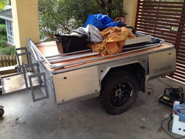

Post Posted: Wed Mar 14, 2012 6:53 pm
I stripped the canvas off yesterday so I can fit the flip-top kit. The side access doors are handy but cumbersome for loading and unloading.
Also thinking of spinning the tent 180 degrees so the fridge mount and draw bar are under the awning when setup. I'm planning on making an aluminum cover/box to protect the fridge which when in camp can be used as a cooker stand and kitchen bench. it will sit over the end of the draw bar and hitch.
