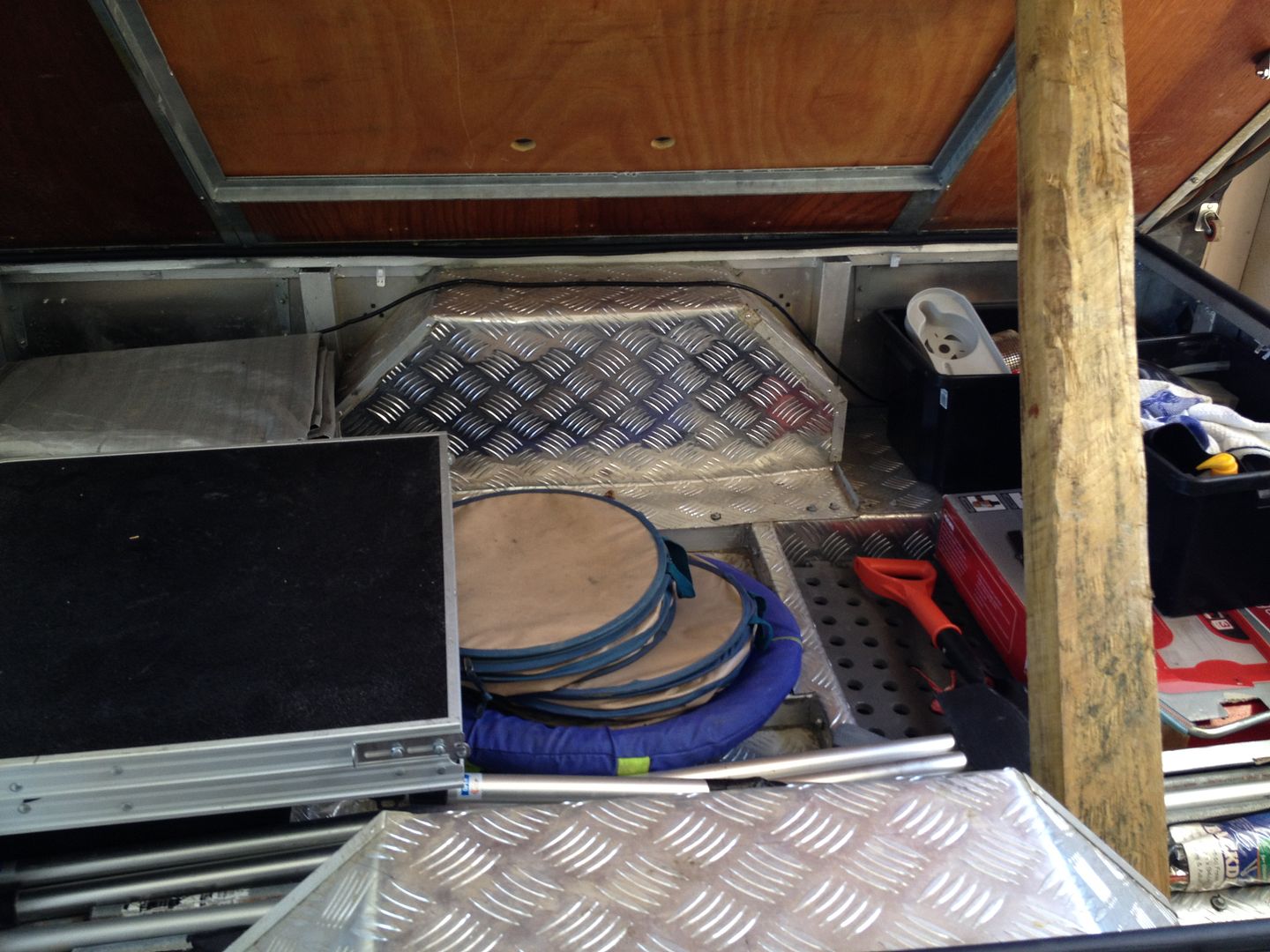

Post Posted: Fri Oct 18, 2013 1:11 pm
what's the plan for those big wheel wells?
Platinum Supporter
Platinum Supporter
Posts: 2155
Location: Nhulunbuy 0880
Vehicle: 2010 jimny
Post Posted: Fri Oct 18, 2013 2:16 pm
dunno. ideas? fair bit of space to play with.
Post Posted: Fri Oct 18, 2013 2:40 pm
Bit of lost internal space too. No ideas myself apart from cutting a wheel arch out of the ally sheet to close up the gap. Would need some bracing though.
EDIT: also I'd make the inner lining only as high as need be so some usable storage space would be created above the wheel.
