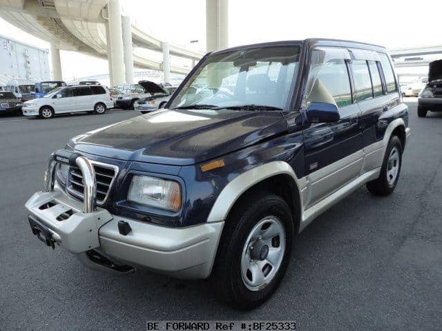

My bet is that is was previously on a "late Goldwin" Edition with Nomade trim ('95 onward, 5000 made) as the brackets seem to match the unique recess and bends in the nudge bar for this version:
From what I can tell, the later Nomade's should have IPF Super Rally's with a deep rear housing that fills to the front of the grill. There's many photo's floating around with those fitted so I'm not sure what's happened here. My best guess is that in the beginning of the "late Goldwin" run they used leftovers from the prior, "early Goldwin" accessories (started '91, 1800 made), or.. the original spots failed and the previous owner put these from an older Escudo on? Either way, this was a great hunt for finding the history of these little things!
