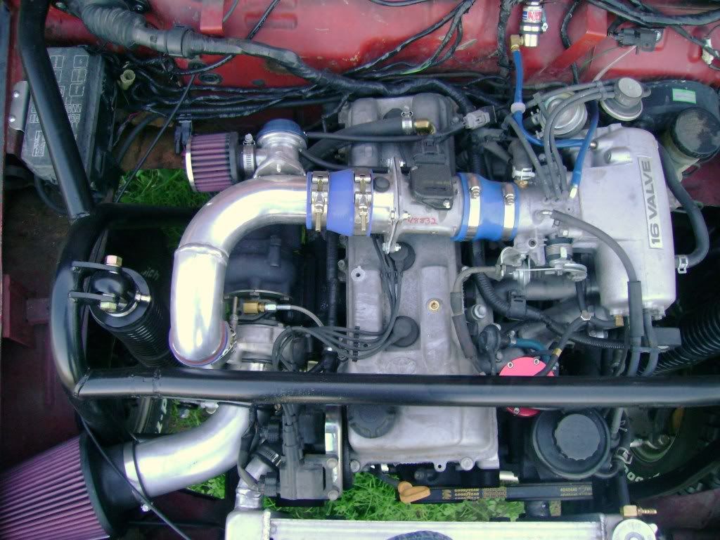

How tight, do you have pic's??
Cause when I put a measure stick across 1.3 & the J18 there's not a lot of difference.. water pipe out the back would have to be moved, but the vit eng shouldn't have that trouble.. I'd like to have a closer look at a J20 vit eng out of the car.
I've made other eng's fit, J should go in nicely.. 8)

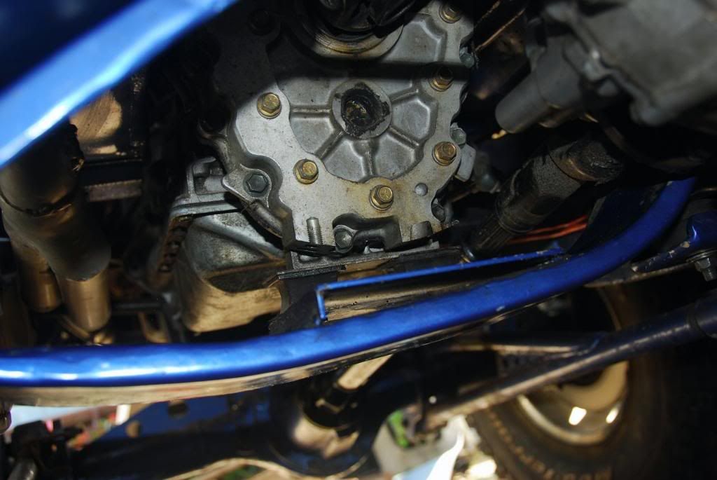

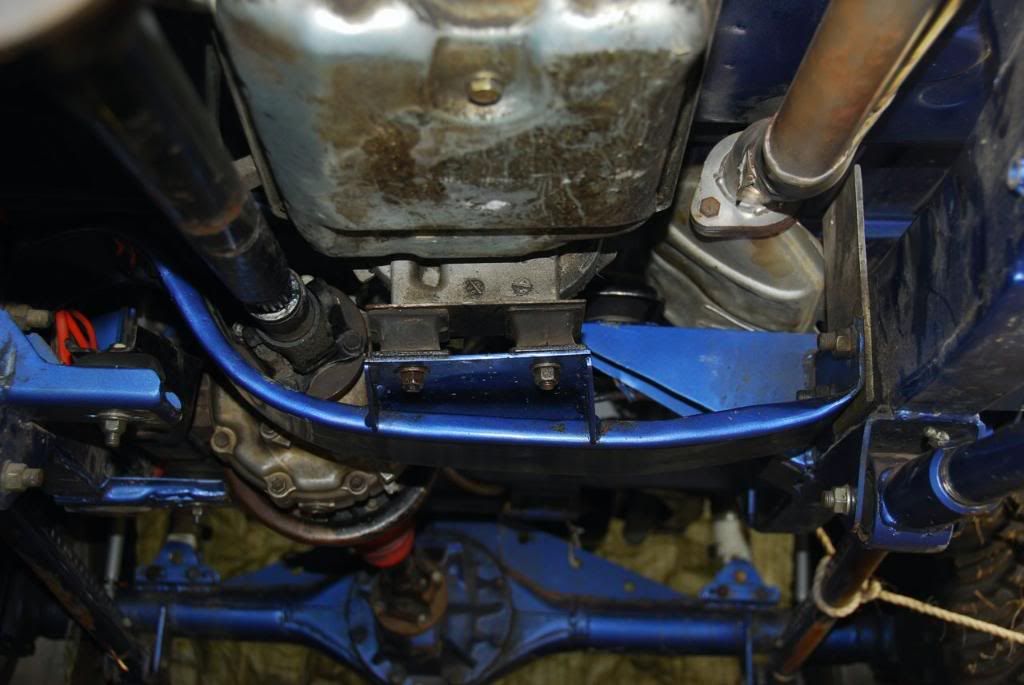

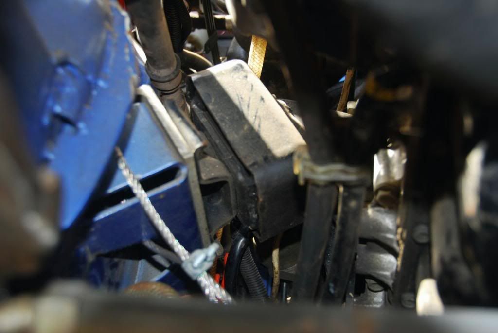

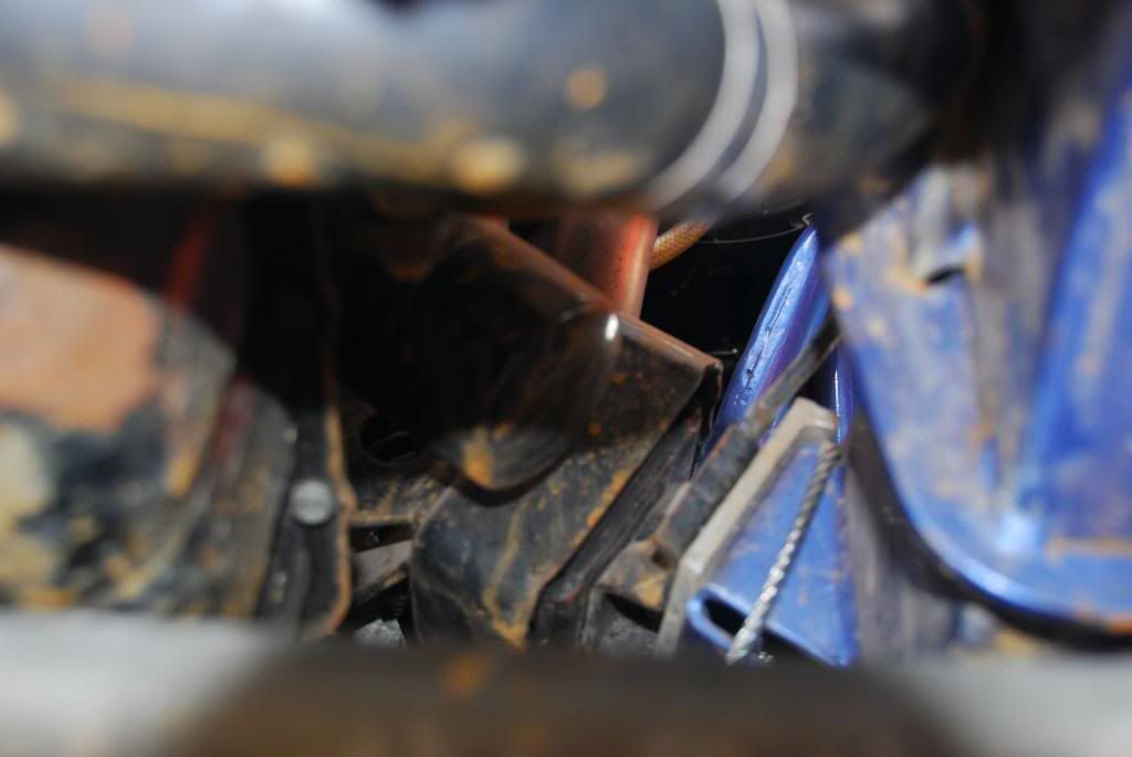

Post Posted: Sun Oct 10, 2010 10:58 am
Not sure if yours will be auto or manual. This one is auto.
Right side engine mount from underneath.
Rear of transmission.
Left side engine mount looking down. That is an aluminium spacer.
Left side engine mount from underneath.
