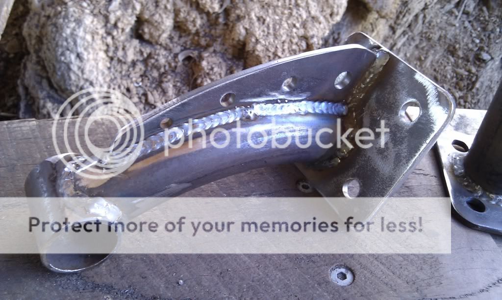

Post Posted: Mon Mar 15, 2010 4:18 pm
cutting off the 1.6 mount
the modified mount, done in vice
sump bashing
braised and mounted
1.6 end onto the 1.3 pickup
