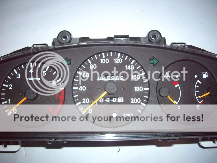

What if I got them to rip out the whole dash with wiring intact? That way I get the speedo/tacho as well?

you will need the vss/speedo cluster/speedo face plate etc from the baleno dash!!
Wrong. Bow bow. :lol:
If he has the coil/dizzy motor.. it still wont work. But i wouldnt bother with the dizzy motor as it comes straight out of the head into the firewall..
Baleno speedo + vss is electronic. Not cable
My thread is for coilpack models. It has it all i think....
Vit/swift cable drive internals with vss with speedo arrow etc.
Stock speedo face or vit or baleno faces.
Baleno tacho internals. Stock sierra tacho doesnt work with twin coils..
I have vit internal speedo with vss.
Baleno speedo and tacho faces/gauges.
Sierra temp and fuel gauges.
All in sierra cluster.

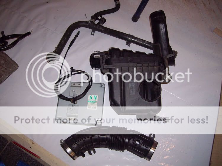

Engine arrived today :woohoo:
I've also got ECU, air-intake bits, and throttle cable.

Post Posted: Tue Jun 15, 2010 1:55 pm
Did you get ALL the wiring and sensors? What about the IAT sensor? Its usually left on the airbox :roll:
The only wiring I think I'm missing is to the fuel pump...
Here's some more "bits".
Is this the IAT sensor? There is nothing plugged into the actual airbox.
Post Posted: Tue Jun 15, 2010 10:57 pm
Yep. You're safe :wink:

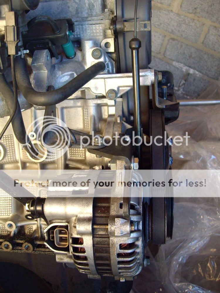

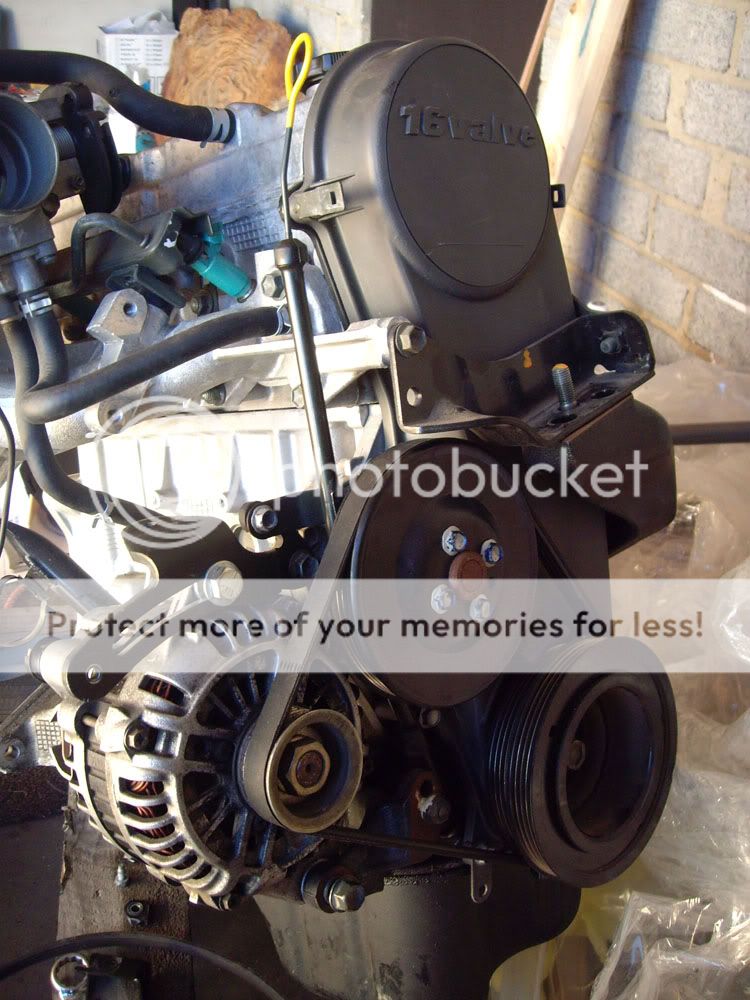

Post Posted: Tue Jun 22, 2010 7:05 am
Fitted the 110amp alternator today. Was almost a direct bolt-on :D
I used the Baleno brackets, just had to grind off a small amount.
Lume is unplugged - ready to be stripped back.
Can anyone tell me, is there supposed to be anything here?
(The threaded hole in the middle)
