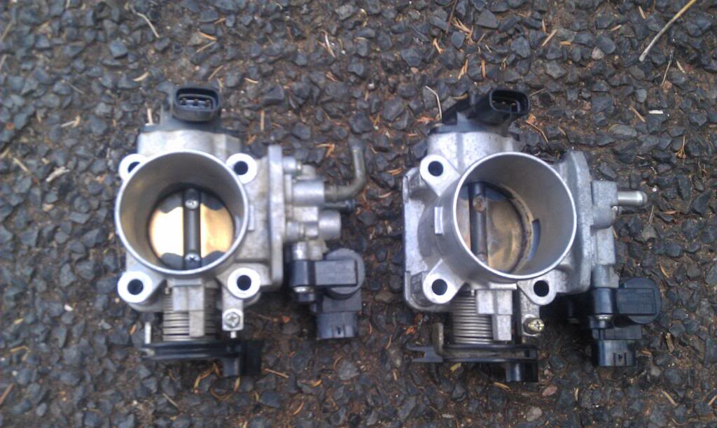

Been pulling bits of my new M15A getting it ready for fitting and noticed that the throttle bodies are the same size and are identical except for a external bracket on the swift and the swift one has the crankcase ventilation fitting on it not on the air pipe like on the jimny. Looking at the fuel injectors they appear to be the same also but will do some research to check.
M15a throttle 50mm
M13A throttle 50mm

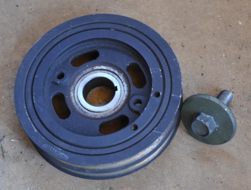

Also was wondering why people have been swapping the main pulley/balancer off the front of the motors as the M15A is the same size? Is there something I'm missing?

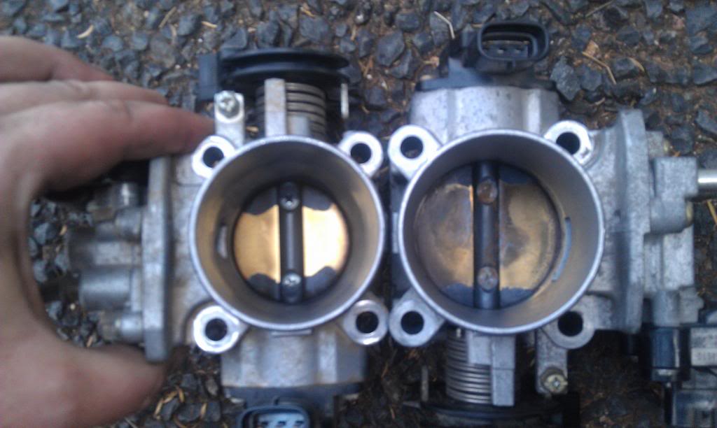

Paulw wrote:
Been pulling bits of my new M15A getting it ready for fitting and noticed that the throttle bodies are the same size and are identical except for a external bracket on the swift ...
The M18A throttle body is definitely different. Side by side comparison photos below, in each photo the M13A is on the left and M18A is on the right.
For the Liana M18A the pulleys are different.
This is a Liana pulley (both pulleys are a similar size):
This is a Jimny pulley (smaller outer pulley):

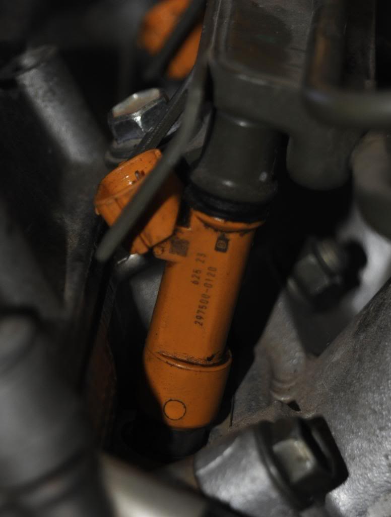

just went and compared part no. on the injectors on the m13a and m15a both are 297500-0120 (200cc),
Thanks Tim just went out in the cold and had a better look at the M13a pulley and it is different from the M15A, cool will undo the bolt on the M13a while it is still in the car so its a bit easier.
Post Posted: Tue Jun 25, 2013 10:40 pm
More info regarding throttle bodies.
Earlier in the year I tried out my M18A throttle body to see what would happen. Initially everything looked good except that the car was idling a little over 2000rpm. I decided to leave it in for a few days and see what it was like. After a day or so the ECU was able to adjust the idle down a bit and it was idling at about 1800rpm, but there was a bigger issue. As the revs came back down to idle after a drive the revs would start to fluctuate, jumping around from about 1200rpm to 2000rpm about once a second. The video below shows what was happening.
Driving at slow speeds was impossible. Just rolling around a car park the car would be idling OK and then it would kick in and rev up to 2000rpm+ (without even touching the accelerator) which would see the car lurch forward and take off all on its own.
In the end I switched back to the M13A throttle body until a solution is found.
One thing I learned from the swap is that the coolant pipes on the throttle body are slightly different between the two. You can see it in this picture:
All it means is that you need to use the hoses from the throttle body you are using as they will be the right length and already bent to suit..

The only parts I used off the swift motor was the injectors and a bare engine.
I have had trouble free motoring since I have done the conversion. I have the same fuel economics maybe a little bit more and much better response in power at low rpm, and I'm even running a stock exhaust.
Me personally I'd use the injectors suited to the motor as there will be a reason for that, more likely they flow differently or set up differently however the tech people say it.
