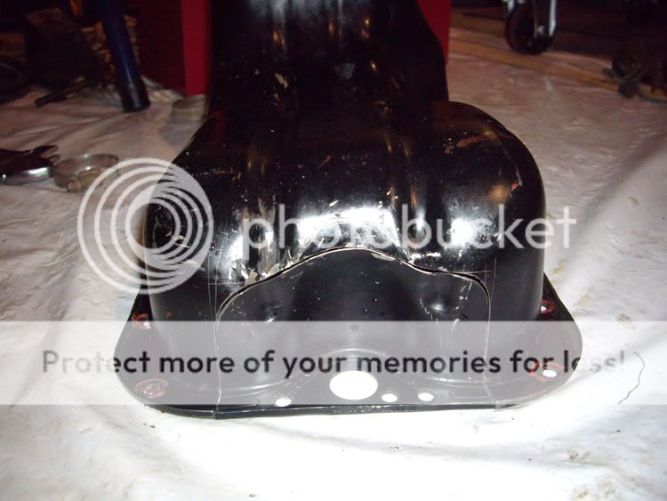

Sumps have been cut. I'll take it to a welder on Monday to get TIG'd.

Just wondering can you weld the sump with an oxy or should you get it tig'd ?

Post Posted: Sat Sep 11, 2010 8:30 am
Either or..
I've welder em with oxy, welded fuel tank's with oxy to..

Post Posted: Sat Sep 11, 2010 9:00 am
Just because i have an oxy but not a tig :) Will an oxy be too hot ? and distort it ?
Just wondering what you cut the sump parts with ?
cheers.
Post Posted: Sat Sep 11, 2010 9:02 am
The one's I welded were cut with rock.. :lol: :lol: :lol:

I cut them with a jigsaw, then spent ages with a hand file to get it fitting nicely.

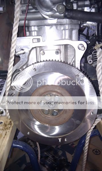

Post Posted: Tue Sep 14, 2010 11:55 am
Thanks Steaks, I ordered one from there this arvo.
Also got new clutch cable, gearbox bushes, and gearbox plugs (cos I had to chisel one out :roll: )
Those mounts look good Phil, I'll get some of them too :)

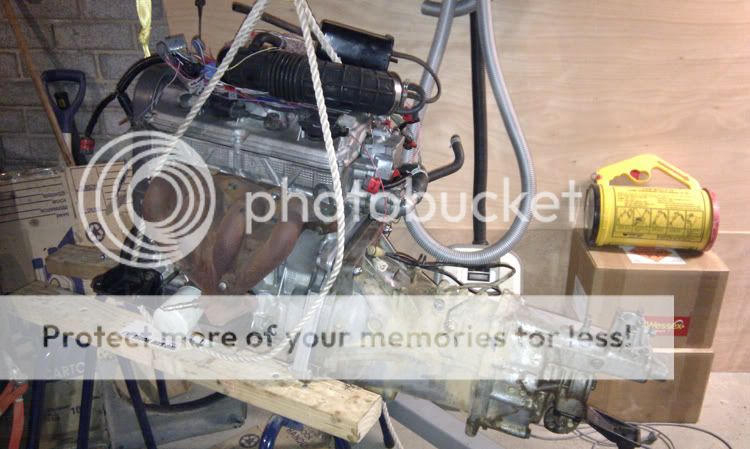

Here's my very flash machined flywheel:

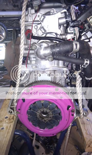

And my pink HD clutch:
All bolted together :D
Post Posted: Tue Sep 14, 2010 12:03 pm
Good luck with the pink HD clutch. I am taking mine out cos I keep breaking clutch cables. :x
Going with standard Exedy :oops:
Post Posted: Tue Sep 14, 2010 11:39 pm
Haven't had an issue at all with mine, feels nice and light on the pedal too :D

Post Posted: Tue Sep 14, 2010 11:44 pm
Looks like the spiggot bearing is sitting too high?
Watch out or you'll get sued.
Joined: Tue Jul 18, 2006 11:30 pm
Posts: 872
Location: West Coast
Vehicle: Zookless
Post Posted: Tue Sep 14, 2010 11:46 pm
It's in flush with the flywheel. Might just look like that because it's new and shiny :)
Posts: 9707
Post Posted: Tue Sep 14, 2010 11:51 pm
I run a single row, double width in mine as the spigot shaft is slightly worn, like most sierra's. But to get the flywheel bolts undone, you cant just hammer it in to get them undone as a socket wont get full contact, i have a dynabolt welded to rod as a slide hammer/bearing puller. Works a treat. :lol:

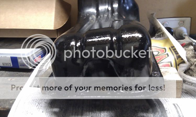

Here's the welded sump, with a fresh coat of paint:

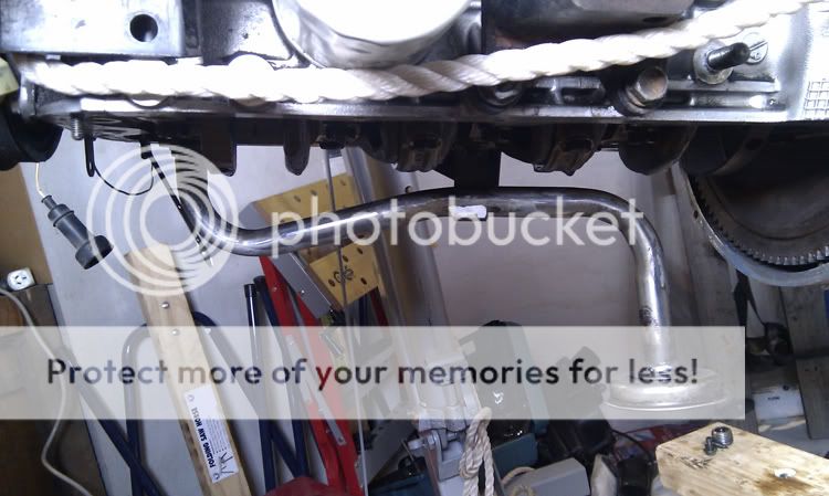

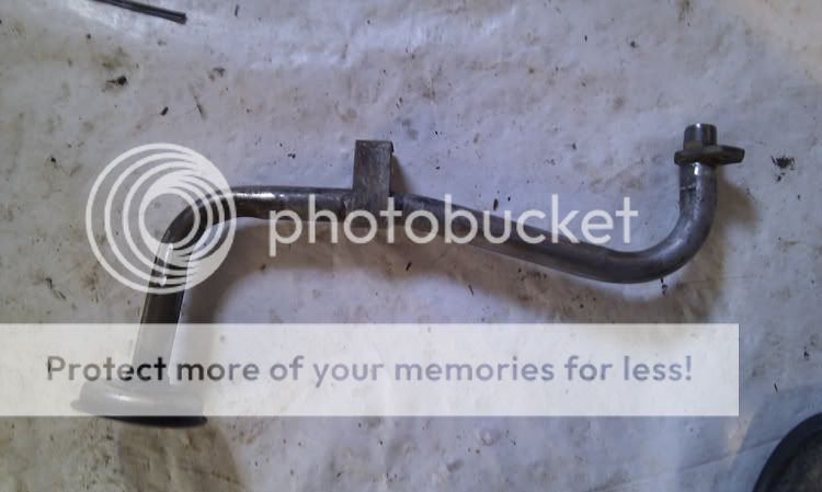

I cut the top off both pick-ups and fitted the Baleno top into the Sierra tube.
The support tab was also cut off the Baleno and welded onto the Sierra tube.

Post Posted: Thu Sep 16, 2010 9:11 am
The Baleno dip-stick looks like it's about the right length.
What do you blokes reckon?
