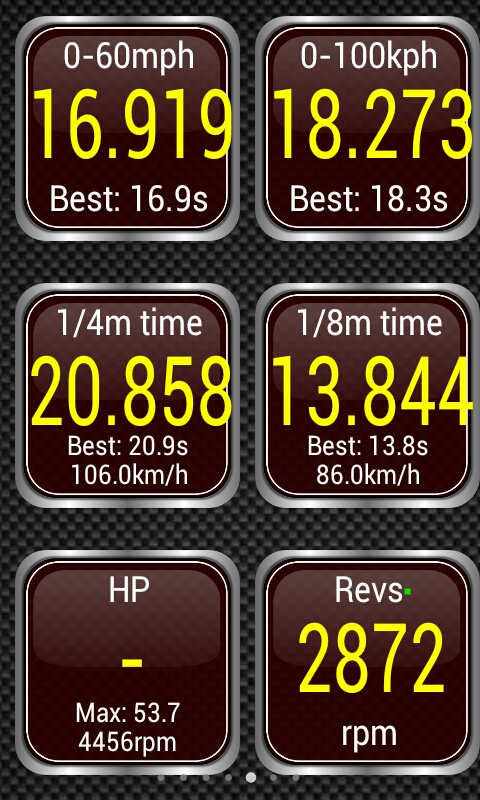

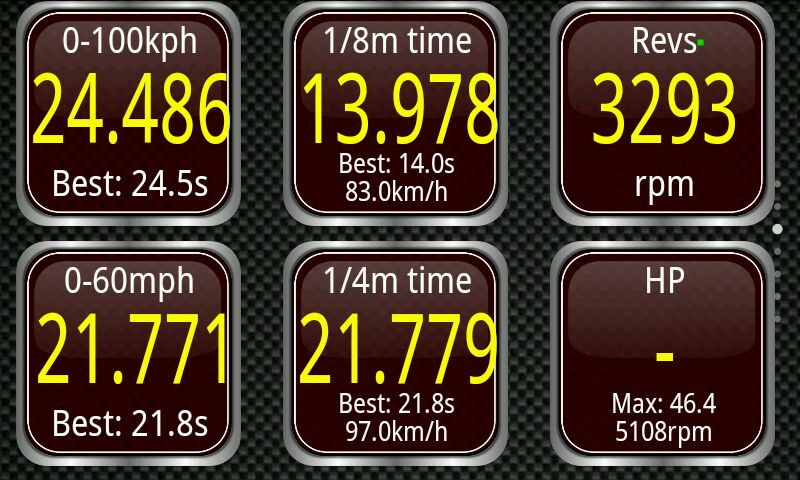

I just posted this in another thread but thought it would be useful to post in here too.
tim80z wrote:
Here's some numerical results between the M13A and M18A. Obtained using a cheap ELM327 OBD reader off ebay and the Torque Android app.
M13A a few days before removal, best of 3 runs:
M18A about a week after installation, best of 3 runs:
I was probably still getting used to the M18A a little and short shifted slightly.

Post Posted: Thu Nov 08, 2012 11:06 am
thats not a great improvement in speed but must be better in crawling with the extra torque and pretty much driveability all round. Maybe more worthwhile doing a toyota supercharger conversion? probably 40 to 50% performance increase if the ecu can be modded.

Post Posted: Thu Nov 08, 2012 2:28 pm
I seriously doubt that the M18 is at its full potential with the M13 intake assembly and ECU. Though a 6+ second reduction from 0-100KPH is pretty darn descent! Roughly a 34% improvement.

Post Posted: Thu Nov 08, 2012 2:49 pm
I find the 1/4 and 1/8 mile times and speed interesting and I think shows that the top end is where the M18 starts to pull ground on the 13.
Assuming bigger tyres, I'm very much thinking that a well geared 1.3 against an un-geared 1.8 would be very similar 0-100.
Post Posted: Thu Nov 08, 2012 2:52 pm
Also, does this app use ECU speedo reading or Smart Phone GPS speed? This would shorten the ET
Post Posted: Thu Nov 08, 2012 3:52 pm
Just for some perspective. Boostedbrick's tinny with a G16 baleno and 235's (i think) ran a 17sec 1/4 mile with a slipping clutch :D
Post Posted: Thu Nov 08, 2012 5:05 pm
I'm pretty sure its GPS speed.
Posts: 645
Vehicle: On the lookout
Post Posted: Thu Nov 08, 2012 5:08 pm
Yeah I think you're right, the kick comes in for mine hardest in 3rd, 4th, 5th gears. 1st 2nd are still horribly slow, and the gearbox in the jimny doesn't like to be rushed either.
