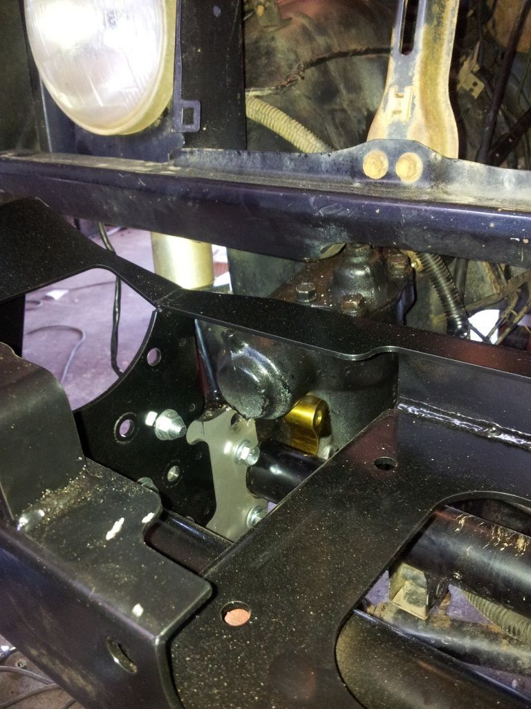

Has anyone else done the power steer install with the JML front bar? I cant fit the steering box because its hitting the top bolt of the bracket, looks like i'm going to have to remove the top bolt for the bracket as well as grind it a little, and just run the 2 bolts on that side...

Post Posted: Wed Jan 08, 2014 8:46 pm

Post Posted: Wed Jan 08, 2014 9:45 pm
thats my issue exactly... bugger.

Post Posted: Wed Jan 08, 2014 10:34 pm
Just grind it away till there is clearance. Do same with the bolt head.

Post Posted: Thu Jan 09, 2014 4:42 pm
got the box in with some grinding, same with the pump (had to notch part of the headers)... next (very n00b) question: is this a collapsible steering column? Thought I'd read the WT maruti has the collapsible type but this wont fit... and i wouldnt have a clue how to tell the difference.

Post Posted: Thu Jan 09, 2014 5:01 pm
Yep that's a collapsible, There will be 2 plastic pins holding it where it's at, See if you can find them (may have to sand some paint back) and knock them out. Then simply adjust to fit.
