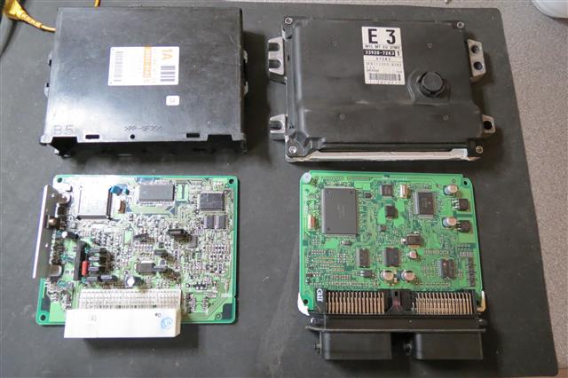

I've got an M15 ECU here to compare against the M13 but I haven't got round to opening it yet, I might try that this afternoon

Post Posted: Thu Jun 27, 2013 8:02 am
^ Cool, so do you think they can be re-tuned if they are based on the same ECU?

They can be reflashed but you need to get in via a back door to get the unlock code. The earlier M13 uses a 68HC16 the programming language of which I'm reasonably familiar, the later ones I suspect use an Hitachi processor that may require a bit of learning.
I Hope its a denso processor then in theory If I can get a definition file made up I could use my Tactrix cable to have it retuned.

Denso don't make processors, it'll be a Motorola or an Hitachi. I'm not sure about the Tactrix cable, it only used to support Subarus which use a different protocol. They have been expanding the range so it may work, you would need to ask them if they would be willing to add support.
