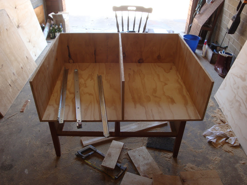

I have been wanting a set of rear drawers for quiet a while as I have been doing a bit of camping and aiming for an easier way to pack and unpack. After doing a bit of researching, surfing and asking a few questions I came with these.
First off I grab two sets of runners off the bay, the same as these 4WD Drawer Runners/Fridge Slides H/Duty 700mm 100kg
Paid $85 each and are heavy duty ... and heavy 8O
Off to bunnings and bought three sheets of structural grade 15mm ply at $55 a sheet plus 100 wood screws 40 mm long.

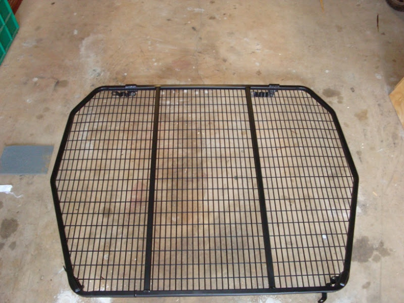

Clearing the back of the buzz removing what ever was left of the rear seats, took the cargo barrier out, and a quick lick of paint:

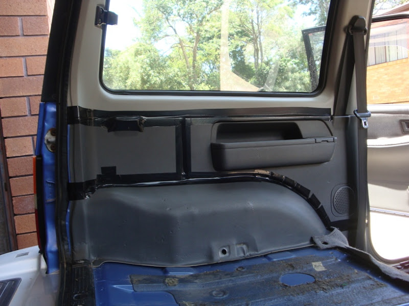

Put some tape over the edges of the plastics to try and keep the dust out:
the tape is starting to lift in some places so I am not sure if it is going to stay. I had tried tape under the plastics and pierce a spot for the clips ... better but not 100% so I thought I would try this method. See how it goes :lol:
After a bit of scratching I decided to keep it simple and make it a box with no fancy angles 'cos there are just so many options and this was my first go at something like this. I may have to revisit here with some packing later but lets get started.

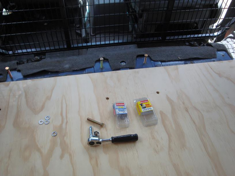

First sheet cut 1040 mm wide and 800 long. I am going to use the insert used to original hold in the rears seats, four holes drilled and some bolts from super crap I had my base down:

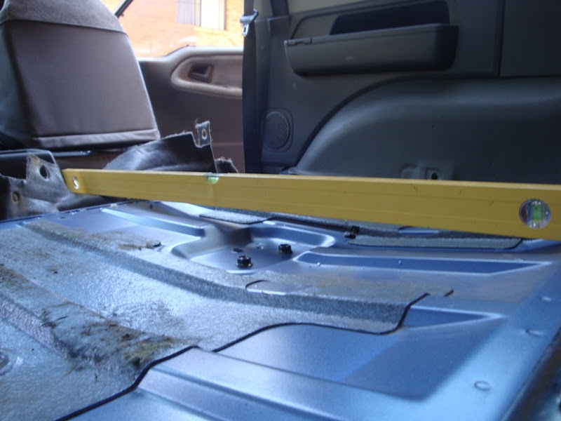

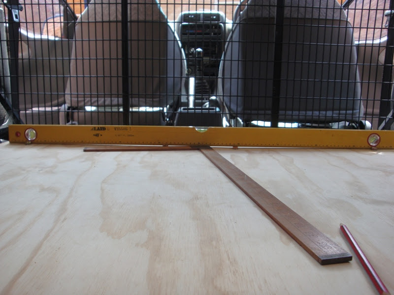

First fit and there is a dip in the middle:
So I packed it up a bit to help keep it square:
I decide the right height to suit what I was after was an overall height of 265mm. Taking into consideration the thickness of the ply around the base and top (and the back) I cut up the sides, middle and back for my drawers frame. Drilling holes first (50 mm in from the corner and then every 100 mm) in the sheet, I screwed it together whilst trying my best to keep everything square :
Only putting in a couple of temporary screws I mounted the runners (packed underneath so I don't fowl on my mounting bolts) and came up the lengths for the base of the drawers themselves of 466 mm wide and 765 long (I wanted a bit of space at the back incase I wanted to the front of the draws recessed later on). A height of 265 also gave a bit of extra space at the top.

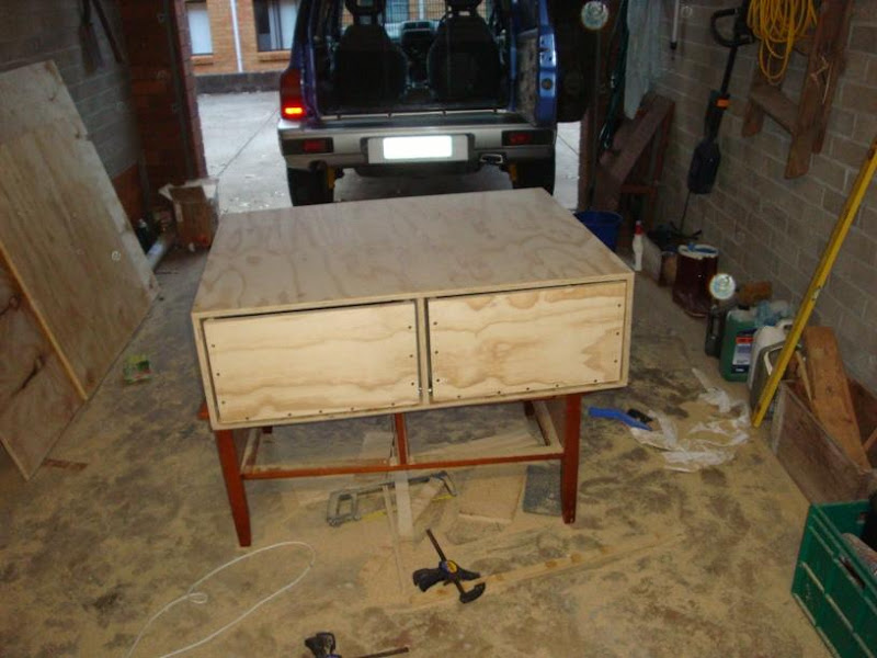

By now the garage is a mess so I cut the top (same measurements as the base)
and screwed it all together and finally squared the hole lot off with a belt sander. i have to take a bit out of the back of the draws so I could pull them out :oops:

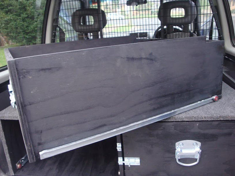

I then pulled the draws and the base apart, one section of a time and used exterior proof wood glue and rescrewed back together leaving the top off so I could paint. it all Around $15 for a 1 ltr can of back paint (and used most of it). Then glued the top on and a second lick of paint to touch up the rough parts:

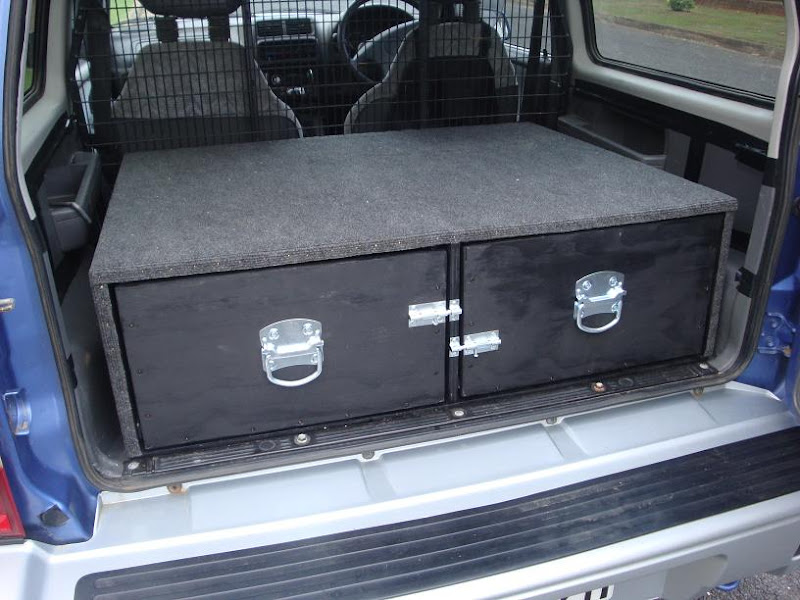

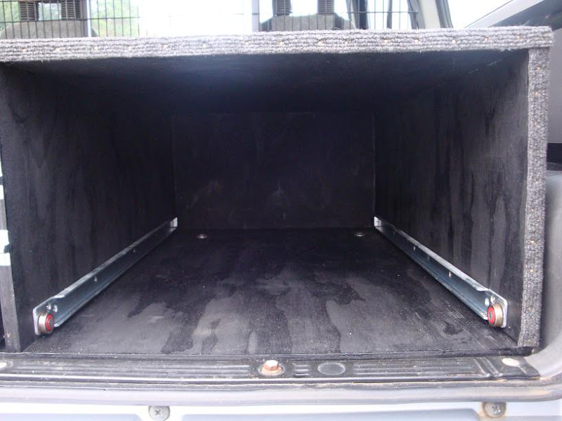

Then off to Clark Rubbers and bought 2 meters of exterior carpet at $22 a meter (its 2 meters wide) and 500 ml of contact adhesive (could of use twice that much) I covered the drawers overturning the edges and pining the edges with nails. Some locks and handles from bunnings and job is done:

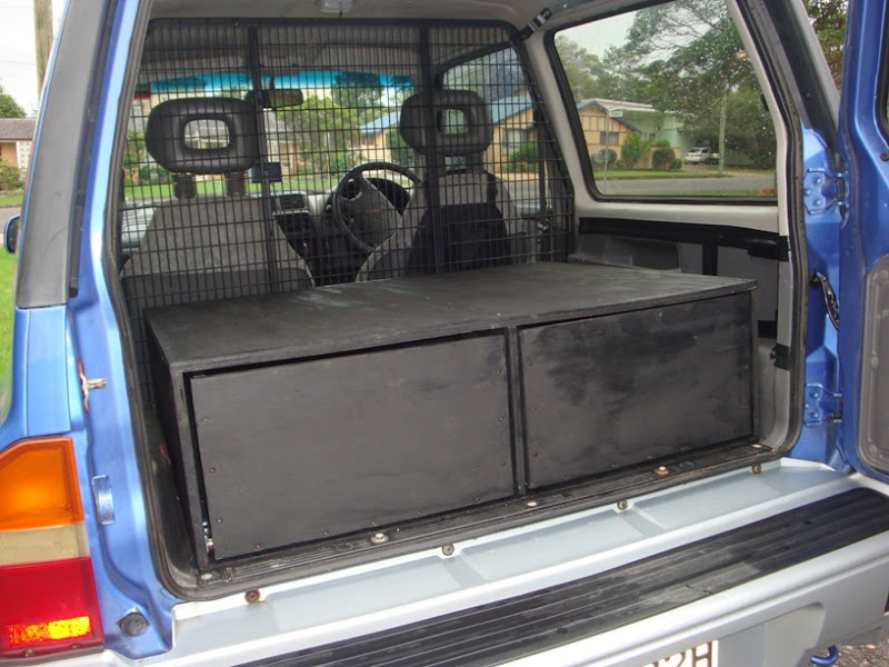

I still have enough ply to make a rear shelf along the rear gate (and I think enough to go towards the second work bench I have planned) and carpet to cover. I am just tosing up if I want a full length bench along the bottom (but won't be able to get into the draws at all when down), a half length bench or a full length bench but runs along the top of the trim?
I'll work something out and it will be just how I want it 8)
Hope you enjoy :D
