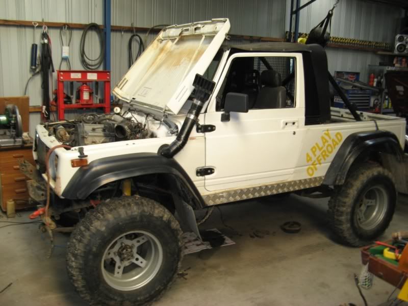

tab bought his sierra a while ago now and the first stage was to chuck some bolt in gear to get it ready for one of our tassie trips. this consisted of 5.12 diff centres, front and rear air lockers, 2 inch alloy body lift and 50mm old man emu springs. to say the vehicle was good with that setup is an understatement.
now we are up to stage two which will consist of heaps of fabbed stuff. this time around she will be gettin a 1.6 vit efi, 4 speed electronic auto, dual cases and power steer. heaps of work but the benefits are fantastic. here is a pic of a lwb we picked up cheap wth 1.6 and f&r lockers. this was the donor vehicle for the power steer and engine, and his sisters vit scores the lockers.
will be taking lots of pics of his truck this week so stay tuned.

How snug are the duals in a SWB?? Wouldn't the rear shaft be a bit short??

well the lwb will be rollin, minus 5.1's for my v6 vit, but will keep all panel and chassis as is, we're just taking diff gears and driveline. and the tailshaft is only about 50mm shorter with the duals.
