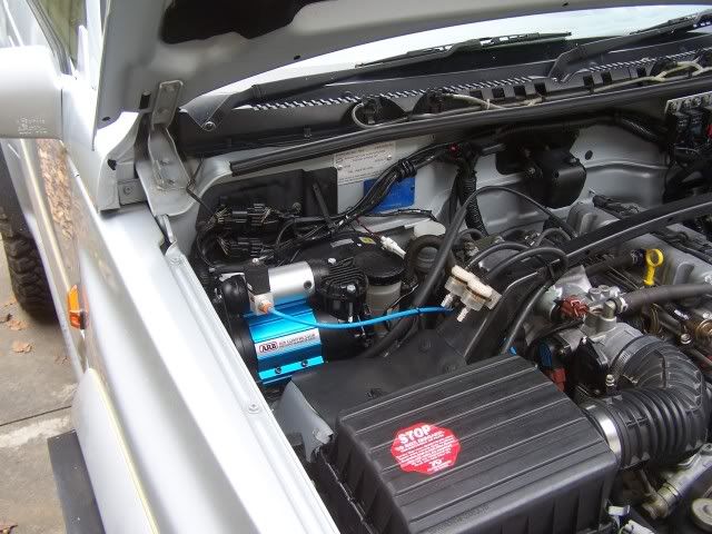

Imagethats mine which only has the diffs hooked up at the moment with a breather cap that works like standard.Also i believe with the clear hose the hose with the red line around it is oil resistant or is my boss pulling my leg?$13 dollars from local bearing place for the Y piece,Breather cap,2 1/2" hose tails and 4 hose clamps.Bout $25 for hose

All done gents..I went down the road that want33s had done. I shared a breather with the t'fer and box - is that ok or a bit dodgy?? You won't believe me if I told you all that I tryed 3 supercheaps and no filters...repco only had 3!...I assume it will do the job...sorry if it looks like a copy of yours want33s...I am hoping the trusty garden hose will hold out..time will tell
Thanks to those who commented...helped me out a lot.
