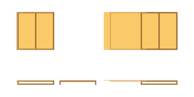

I've decided to make a more professional version with a slide out extension. I love my MIG (have I mentioned that somewhere already??)
Stretched out in the original version
The new version
Collapsed
Extended

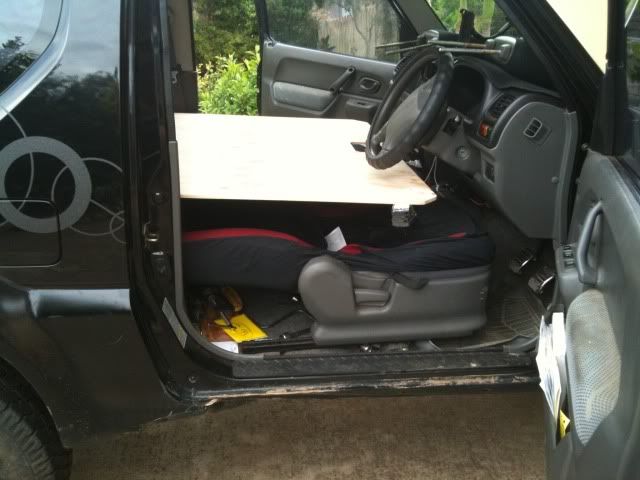

Remove headrests and seats fold flat. The frame sits over the top. I've actually slept in my car on the seats. Not very comfy though

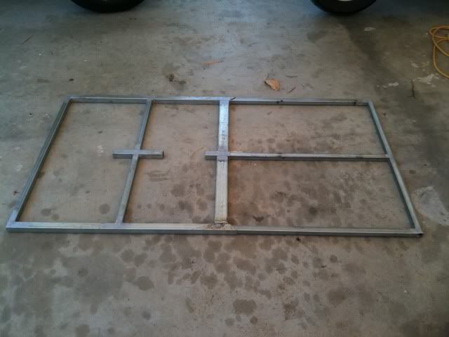

Changed my initial plans for this. Now making a complete unit

mate, looks good, however i would increase the size of the steel to something like 50 x 50 x 6 mm shs, just to be on the safe side should you be lucky enough to encounter any intimate moments :wink:
I'm not that heavy and neither is the Mrs. :-D
When the plywood top and sides are fitted that will give it the extra strength to make sure all goes well. As for amorous activity, I'll usually be camping by myself when I use it. I don't want to over engineer it as I often do. Has to be light.

how come the middle tube is not the full length, would you have any alignment issues if you were sliding it back in, and the inner tube doesnt slot back in the hole :wink:
Haha yeah, I ran out of that size tube, so did the next best thing. It lines up but there is a bit of binding that I need to address. The bit that sits in the middle was really just to stop the centre leg from vibrating when it's collapsed.
But yes If I did it over that tube would carry all the way through

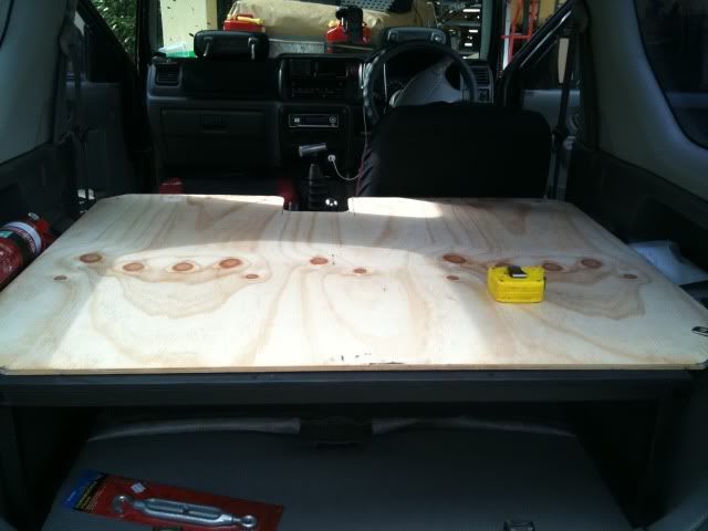

Getting closer now. Has been a progression of adjustments to the plan, but turning out well. I re-welded the outer legs today so now they slide smoothly. Still have to carpet it and make the inner skin and storage compartment base.
Oh yeah, the whole lot will be held in with turnbuckles front and rear. Have found out that the seat in the late model Jimny does not have the bolt holes in the floor that the seats in an early model attach with, so had to change my mounting plans.
Base in its' closed position.
Frame extended
Lower part of the base in place

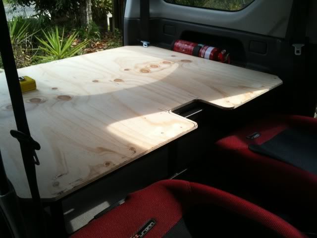

Tested it yesterday and the extension holds my full weight. Pretty good considering it has no supports

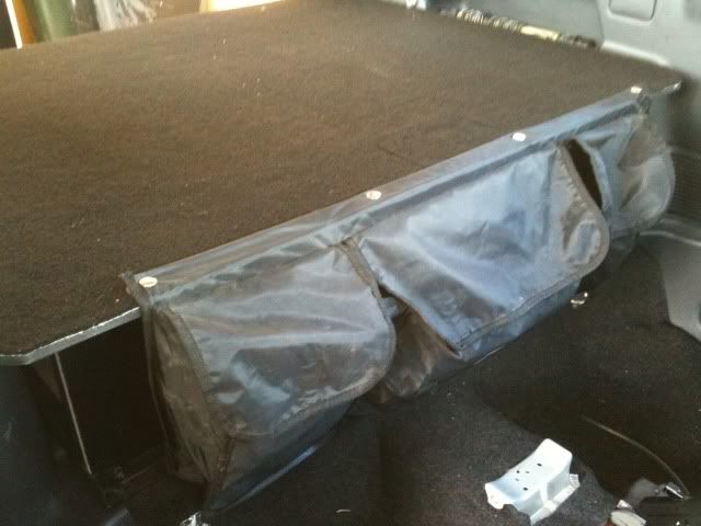

Hung my utility bags on the front of the extension. Will need to be removed when extended

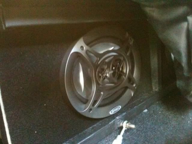

Shouted the Silver Jimny some new 6x9s mounted directly behind the front seats
All ready to load up
With the matress stowed
Set up for Zzzzz
