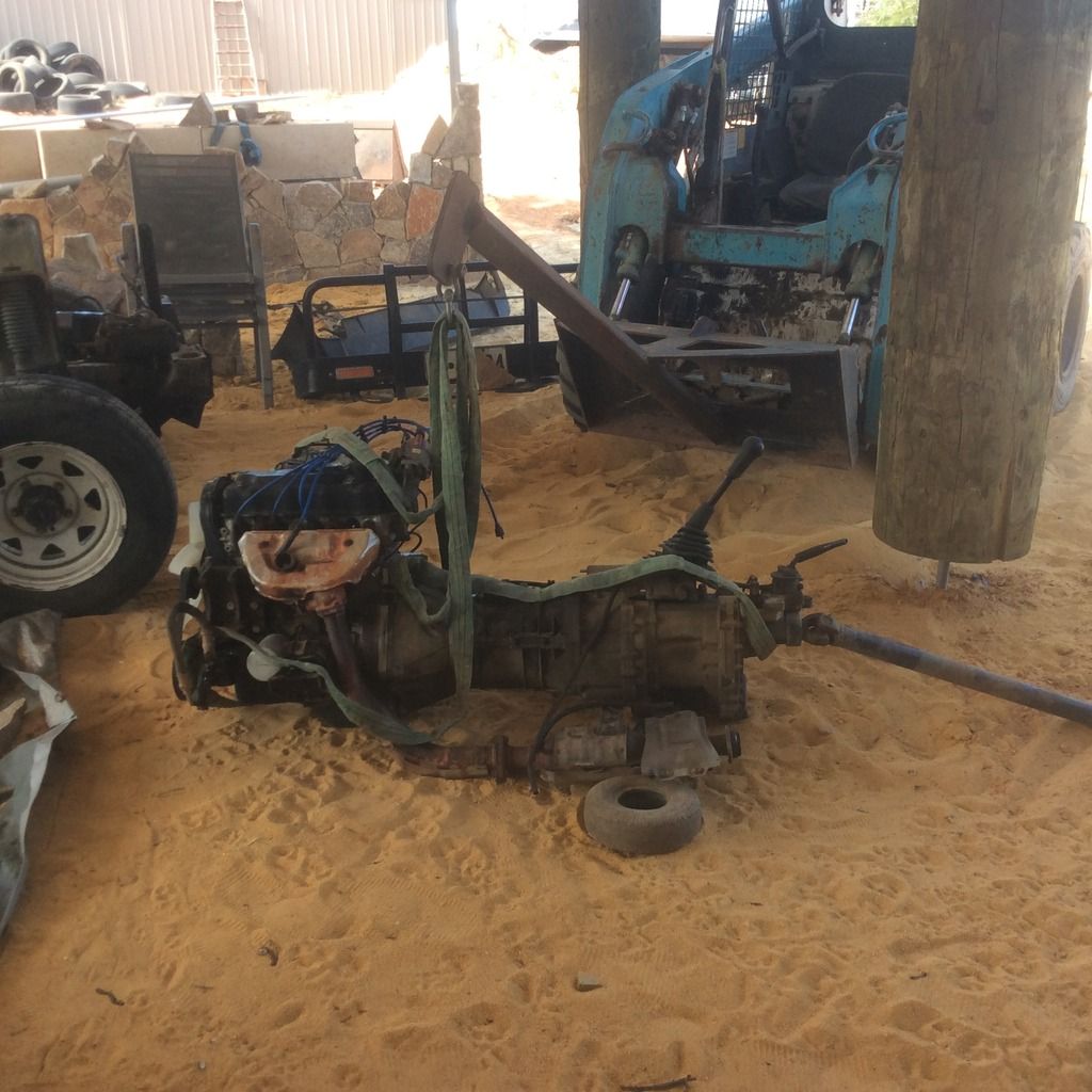

Gday so vitara ruined now hahah I have started the mammoth task of fitting a v8 I no everyone buys a Suzuki for the zippy economy but with this one to hell with it I have a mk triton 2000 as a doner engine is 90000km half cut with A fully rebuilt triton 4x4 box and transfer running a exedy clutch conversion ceramic coated extractors and new tail shafts that will now have to be cut down 8O I have taken body off so chassis bare now I have fitted triton front diff as its lhs tail shaft it's exactly the same as vitara just steel I will get custom cv shafts made from triton diff to vitara stub triton rear diff is same measurements as vitara just leaf springs so going to convert brackets to coil :o axles same length so I will just have them redrilled to Suzuki stud pattern going to go get steel for bracket construction Monday hope all goes to plan cheers matt

Just a bit sandy where you live!

Haha just under my patio haven't paved it yet I have photo bucket acc now one photo loaded none others tho ?????

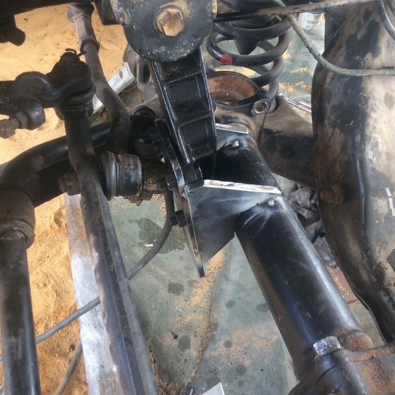

Worked it out haha so I had to trim webbing off the diff centre fits like a glove as centre mount in nearly same spot just needing steel for brackets

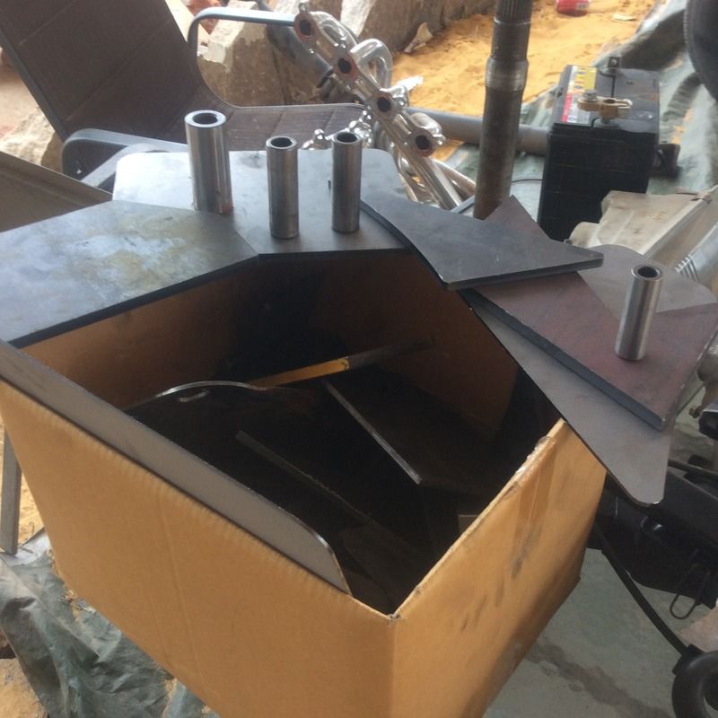

Front diff tacked brackets spent to local steel merchant go threw the laser - plasma scrap bin find so many goodies to adapt wen u need to make a bracket next is to modify sump to fit around diff it already has a sheet metal one as it was originaly modified to triton I'm hoping for engeneering but I guess I'll c what happens going to do everything to the 9s
