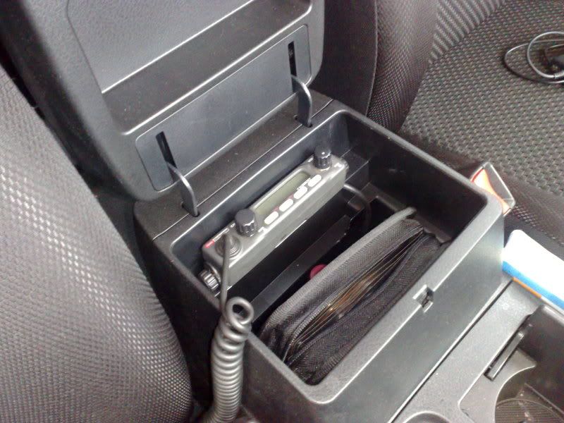

played about with the radio today and im gonna mount it in the armrest/center console. Im using a tx3600 with the detachable remote face. ill post up a pic when its mounted.
Post Posted: Sun May 24, 2009 7:29 pm
Ok i finally got around to fitting the uhf to the 08 GV. the radio i used has a remote head which has made it a bit easier to fins a position for it. I mounted the head inside the center console under the arm rest. and the main body up under the glovebox. there is a bit of room once the plastic panel is removed and once connected the panel is clipped back into position. Can't even tell its there. The reason for putting the head under the arm rest is when not in use the UHF is not seen. only had to drill one hole in the bottom of console to get the interconnecting cable out.
antenna will mount to front numberplate.
