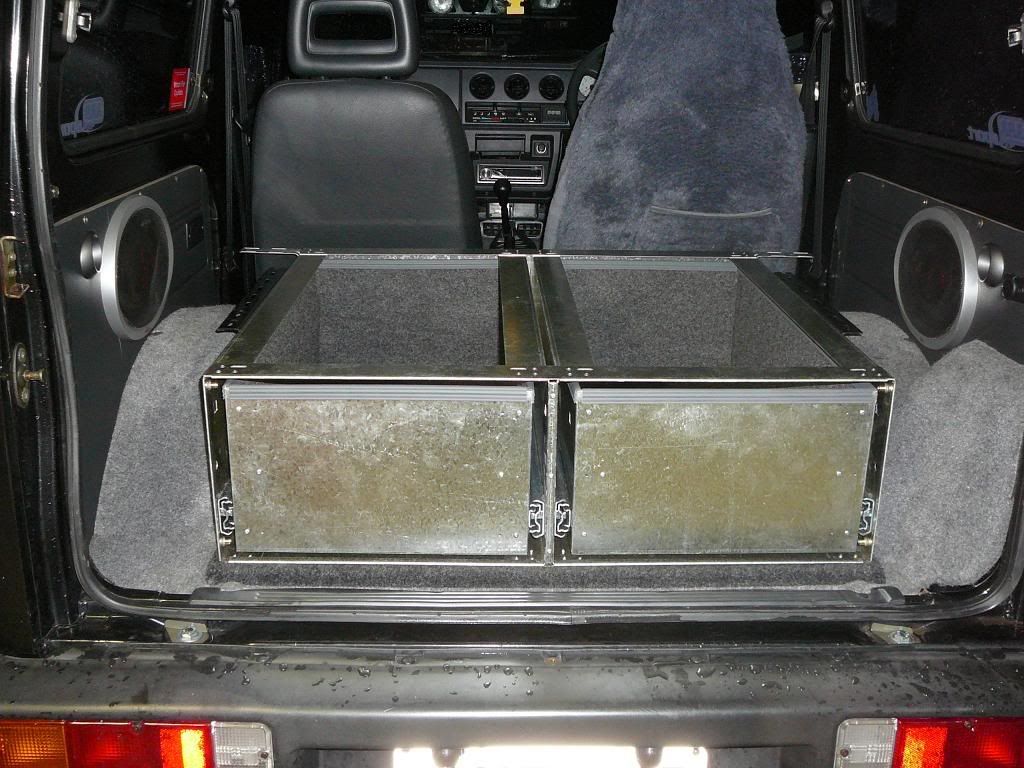

hi every one just thought id post up some pics of my home made draws that i have been makeing over the last week for me sierra
first i got a metal frame made with draws on runners in side to make it easier and stronger
he draws have marine carpet in them which can be easly removed if needed for cleaning etc thay are held in with edging around the top
than i made a base and made mounting points useing the old seat bolt holes
than put the draws in and sentered every thing
cheked the draws dident hit
than made side panels for the front
black coily, 30 inch tyers, 2 inch suspention, 2 i

heres the base painted and carpeted and bolted to the flore
put the draws in and centered than screwed them down
carpeted the sides at front
and at the back

hers the top on and carpeted with storage compartments at the side
hers the front without carpet
with carpet
and with handls

hey mate looking into making a set of these myself so if you dont mind i have a couple of questions.
What did you use to keep the carpet attached?
How is the draw assembly shell together, ie. spot welds or rivets?
Joined: Mon Jan 12, 2009 10:30 pm
Posts: 677
Location: south west rocks, mi
Post Posted: Tue Feb 10, 2009 6:27 pm
hay mate the metal frame is held together with pop-rivets and its just flat gal steal folded to shape, i used contact adhesive glue, you can get it from hard wear shops ect but it is a bit pricey so it works out to be cheaper if you buy the bigger tin. just ask if your got any more questions mate im happy to try and help.

The sliding brackets make a big difference, where did you get the ones you used? They can be pretty pricey but I think it's one of those items it would be wort spending some coin getting decent slides.

Post Posted: Tue Feb 10, 2009 11:31 pm
hay damo i got them from the bloke who made the metal frame for me, im sure he would sell u them if thats all you wanted, thay hold 75kg per draw which is heeps, on his sight thay say there $65 per pr for 700mm long and $85 per pr for 1000mm long.

did you say you had the original draws custom made for that or did you buy them somewhere retail? where they expensive? is it hard to reach into the fridge at that hieght or is it purely for storage and it comes out of the car when in use? cheers jamie

hay jamie, um i got just the metal frame made buy the obove link^^^ he makes them all the time for the draw systems he sells, but normaly there 200mm high and i got mine made 280mm high (i think :? ) so thay were classed as a custom job, you can also get one big draw instead of two like mine and it is cheaper, hell make anyone one any size you want, i also got my carpet of him at a good prise, he did a good deal for me cos my dad has brought 2 draw systems of him in the past, i made mine for half the prise it would have cost me to get them made, give him a ring if you want a quote.
the draws stay in the car all the time but dont take me long to take them out if i want (about 20mins) and the fridge is taken out unless im going on a long trip were it is needed and i can see in it just fine but my short mum cant haha all depends on how tall you are mate lol

could you please take a pic of it straight behind the seats to show what it looks like in there. i am thinking of angling mine and putting 6x9 speakers in there

Post Posted: Thu Feb 12, 2009 7:48 pm
are there wat your after?

Post Posted: Thu Feb 12, 2009 9:52 pm
perfect thanks!!
