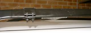

I dont have a bull bar ( and dont quite have the money to put on on either) and needed somewhere to mount my aerial i have seen someone weld a plate off the spare wheel carrier good idea but i dont have a welder :( so next best option was to mount it on the roof rail ( better reception) lots of planing and trying out different designs till i just had to keep it simple stupid (KISS) here are a few little pics of the final product -
sorry about the different size photos
installing CB
Installed
chossing the position for the Aerial
moulded to roof rail
top view
what you see from the side sits flush with rail
side view
when cb is in use (can have every angle in between
bt50 now but still love the zooks

That's a super neat install! Did you run the cable internally or just through the door opening?

I should have said what i made it out of its made out of 3mm steel so its not going any where. i ran the cable through the rail then i went down through the roof now b4 you say anything bad yes i painted it with rust proof and then siliconed the crap out if it and guess what NO leaks yay

Where did you get the rail mount.

well i got half the mount off ebay and made the rest myself the part that wraps around the rail i made and bent to suit but got this part off ebay
http://cgi.ebay.com.au/NAGOYA-RB-56-ant ... 240%3A1318
as you can see from the photo what i have made and what is the original part off ebay
hope this helps
