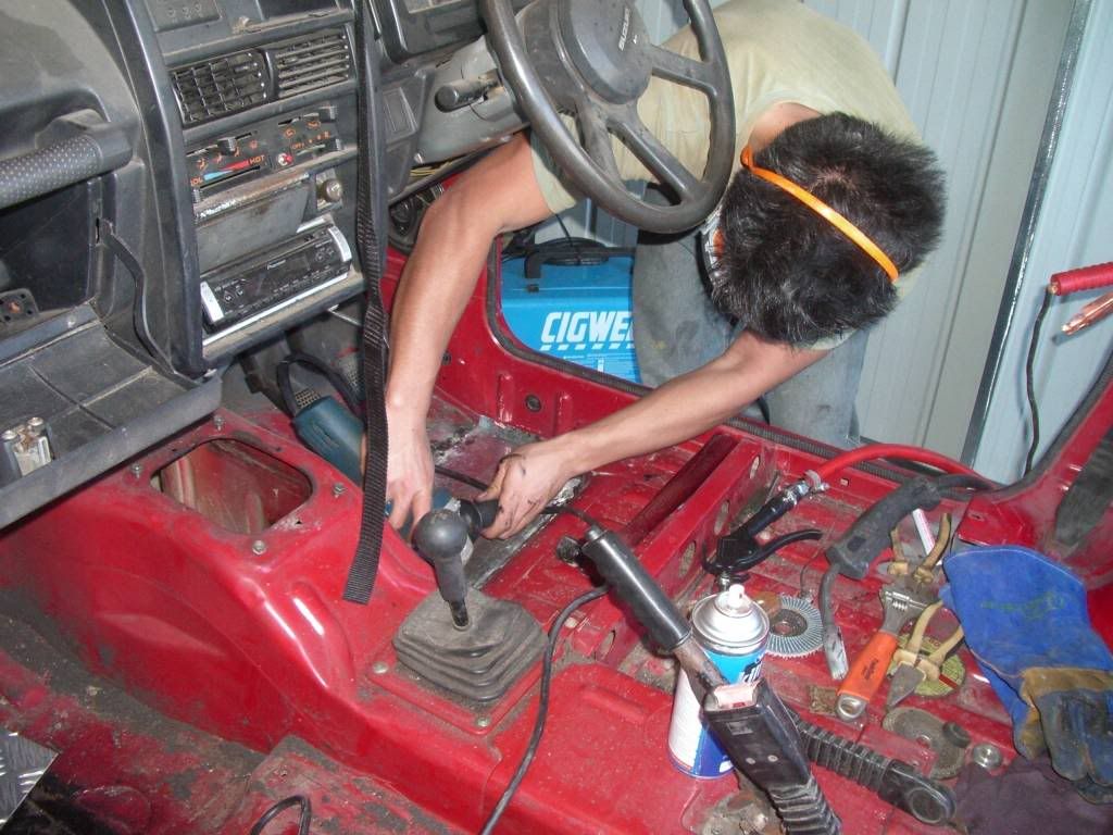

These are a few pics i've taken so far of doing my conversion. I try to take as many as i can.
So far i've taken out the old motor and gearbox. Started taking bits off the old motor and swapping to the new one. Then the battle with rust...

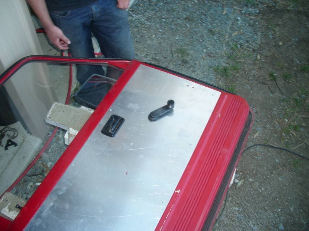

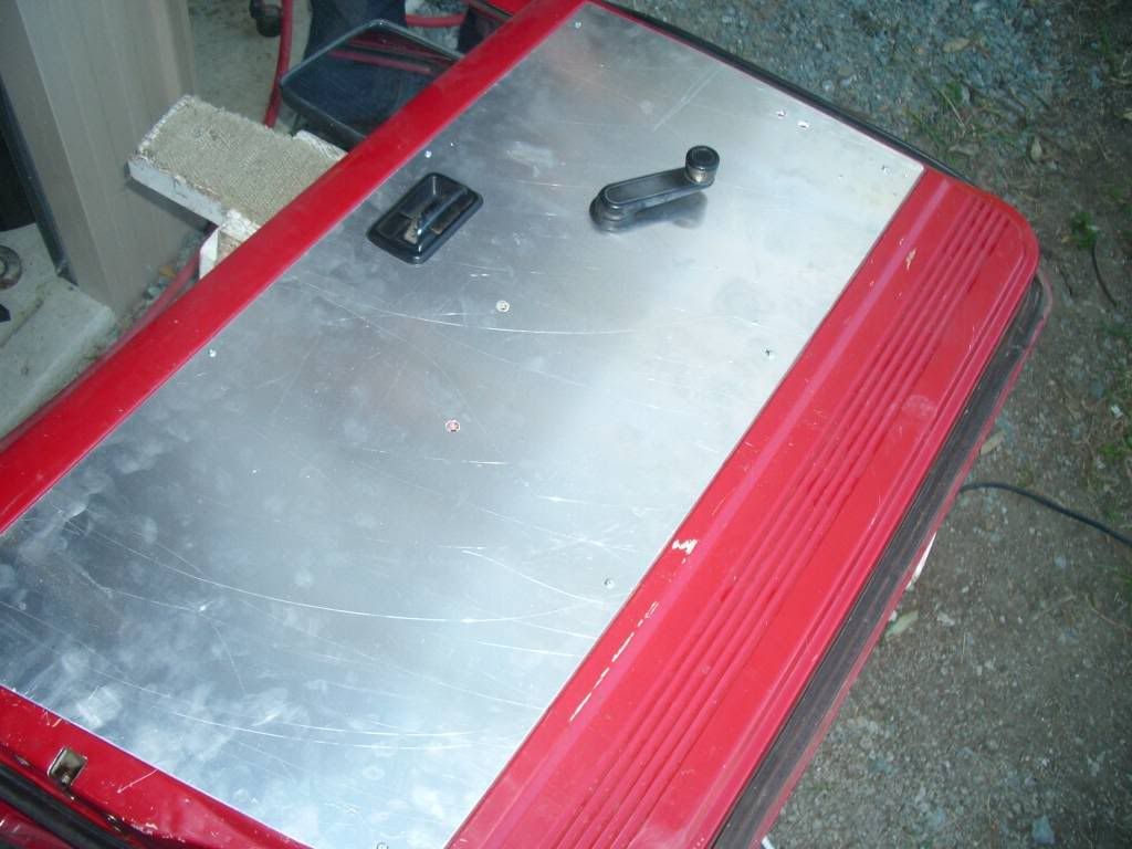

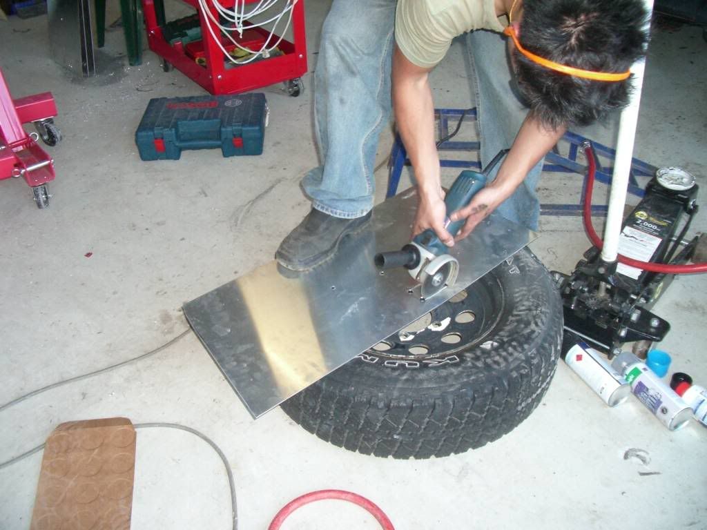

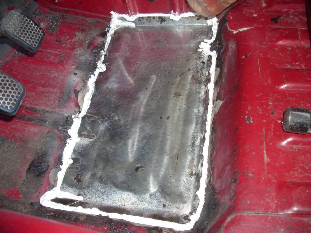

lolz. i'm pissed as at the moment. Just finished drilling out alu door cards for mine and hugo's sierra. couldn't do much else without making a racket for the neighbours. Hugo and pham fibreglassed some holes for me and i made a new drivers side floorpan.

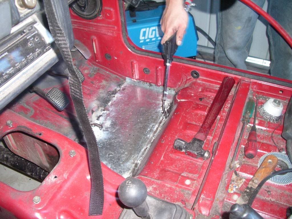

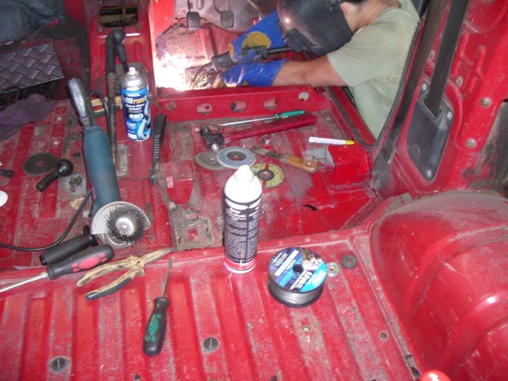

found out yesterday why there was so much freaking rust in the floorpans... some retard covered up the drain holes and welded them up. Fixed that with a 32mm holesaw and a couple of sink plugs :)

If you go to bunnings they actually have the metal plugs in the plumbing section that pop up to drain. They fit flush and look like they are meant to be. What's with working in mossimo kit? That like my best clubbing gear hehe.

We're going to have to ask you to leave Chinny. That kind of workmanship is unacceptable on this site!! We need to see more bird crap welding, hammertone paint and perhaps welding in sunglasses rather than helmet.

That gal sheet seems like a great option for repairing rusty sections - I might have to do it too, I have access to kilometres of it at work...

I was more impressed with the use of safety gear. Good on ya Chinny!

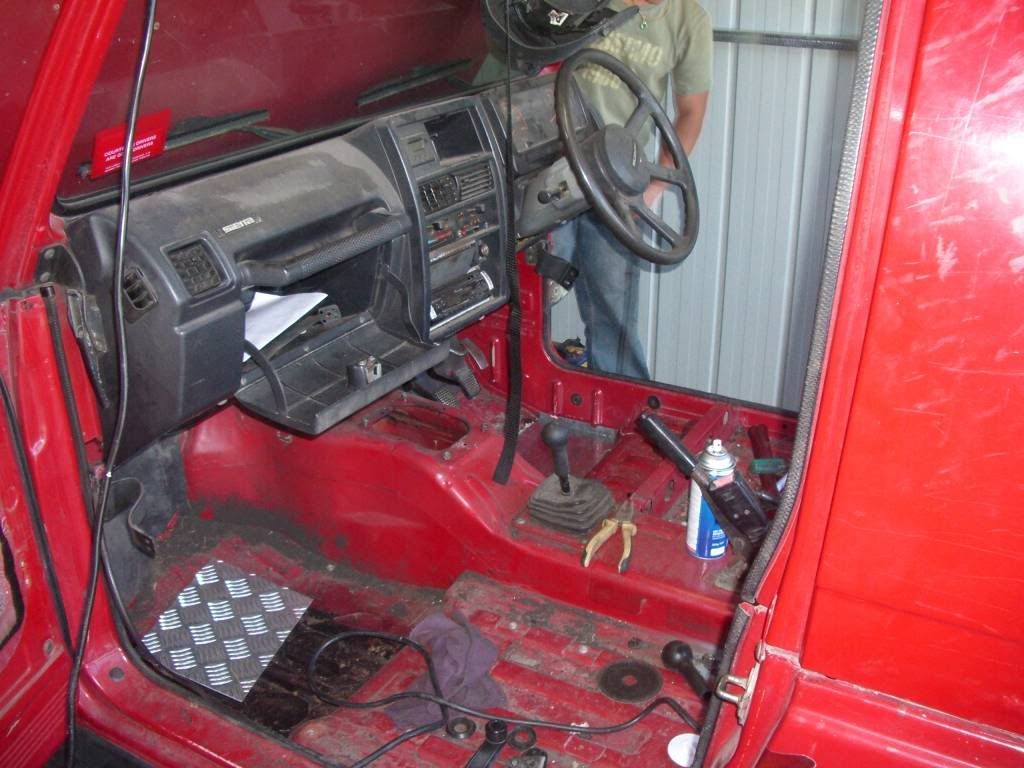

Didn't get much done on the red one today, just filled up the gaps in the floorpan with silicone and painted them with chassis paint. Ran around getting parts and helping hugo with his sierra. managed to get waterpump and engine mount on the white one done
