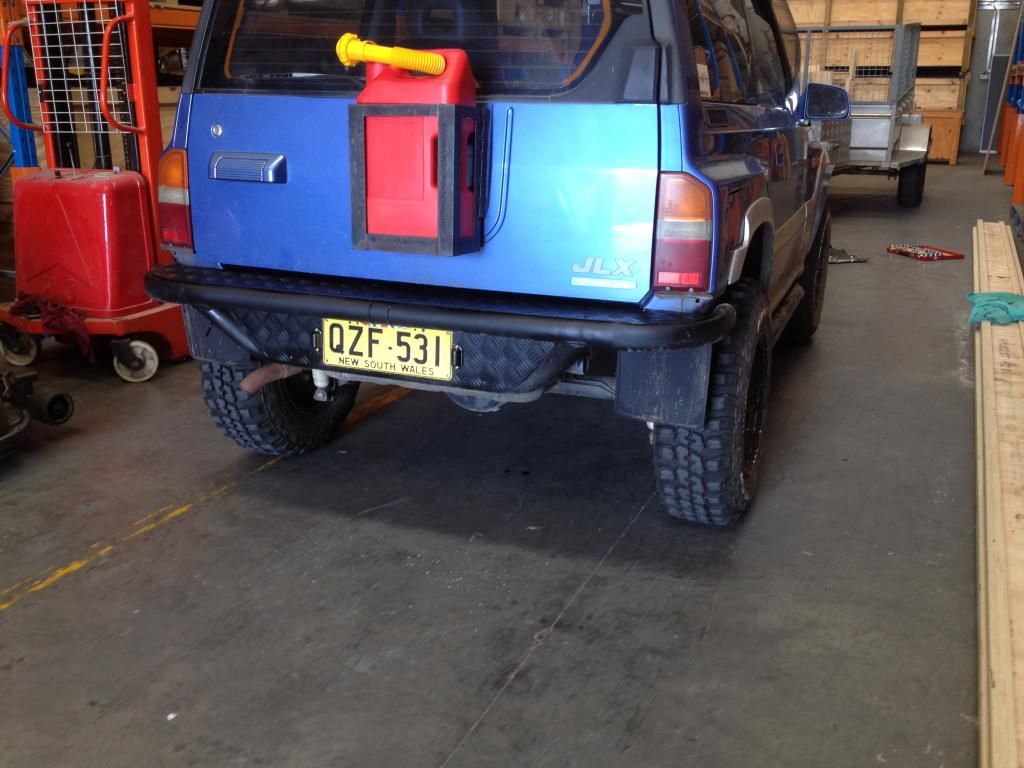

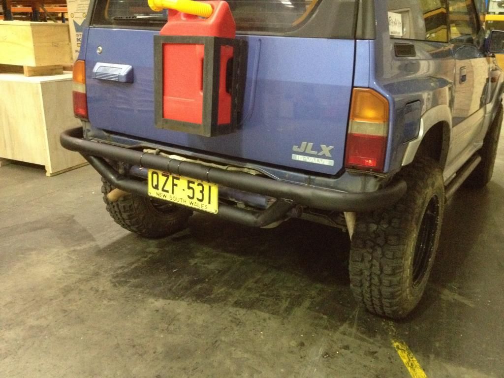

Started making a rear bar last weekend. Pretty happy with how its looking. I guess I should put some mudflaps on? I really dont like the look of them though. Also going to weld on some recovery points and a bit of black checkerplate on the top to cover up that gap and make a step..

Considering that not having mudflaps would be the #1 reason cars get defected I'd be putting them on.

yeh ive bought some mudflaps.. dont need to draw attention to the other parts of my car they could defect if they wanted.
I was thinking of making kind of t shaped recovery points, so i could have the t section behind the bar and then the longer bit sticking though with a hole for a shackle. That way im not just relying on one weld. It kinda scares me too.

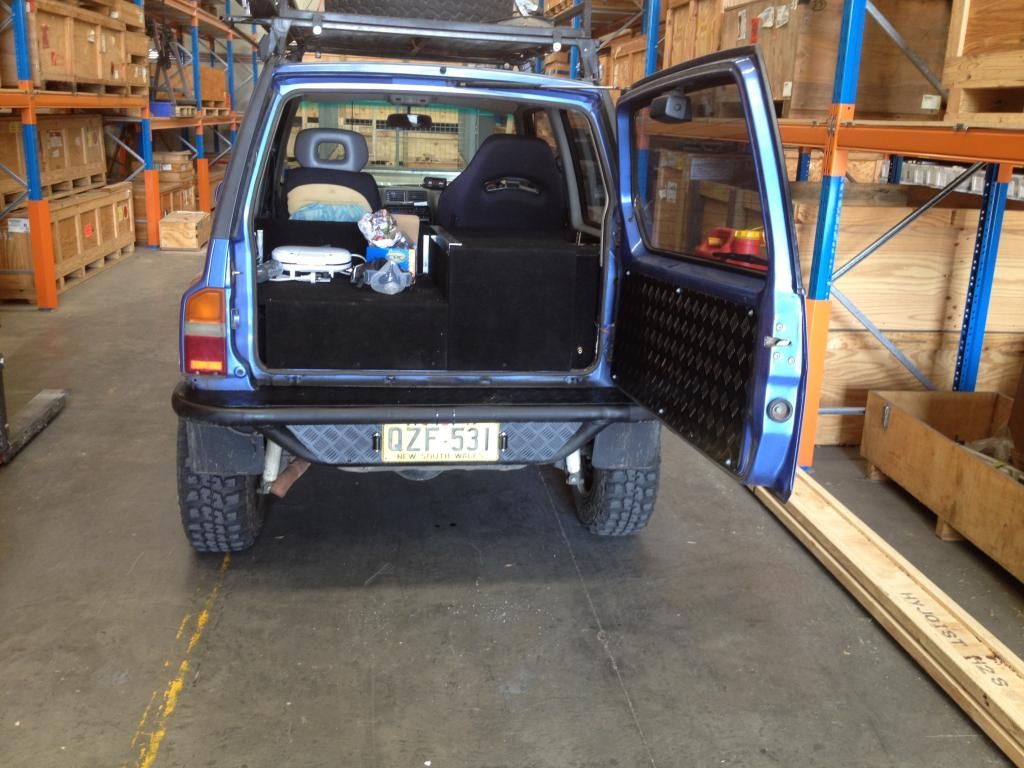

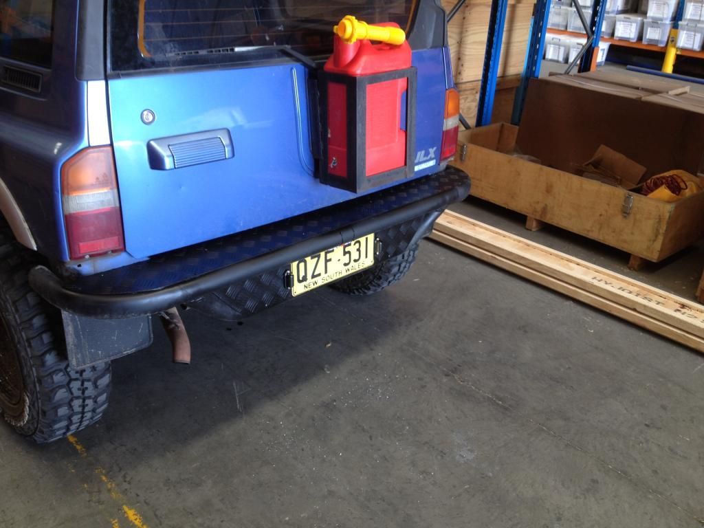

I thought i might update this, the bar is all finished now, mudflaps (not heaps happy with where they sit yet) checker plate and number plate lights. Admittedly it cost a bit more then $60 now but the checker plate was free :)

Thanks mate, im super happy with it now

How did you bend your pipes?
Joined: Mon Nov 12, 2012 11:08 am
Posts: 74
Vehicle: Vitara 1997
Post Posted: Sun Sep 21, 2014 9:54 am
Bosco15 wrote:
Ive just got a cheep hydraulic press bender. Working on making a proper mandrel bender though which should give some better results

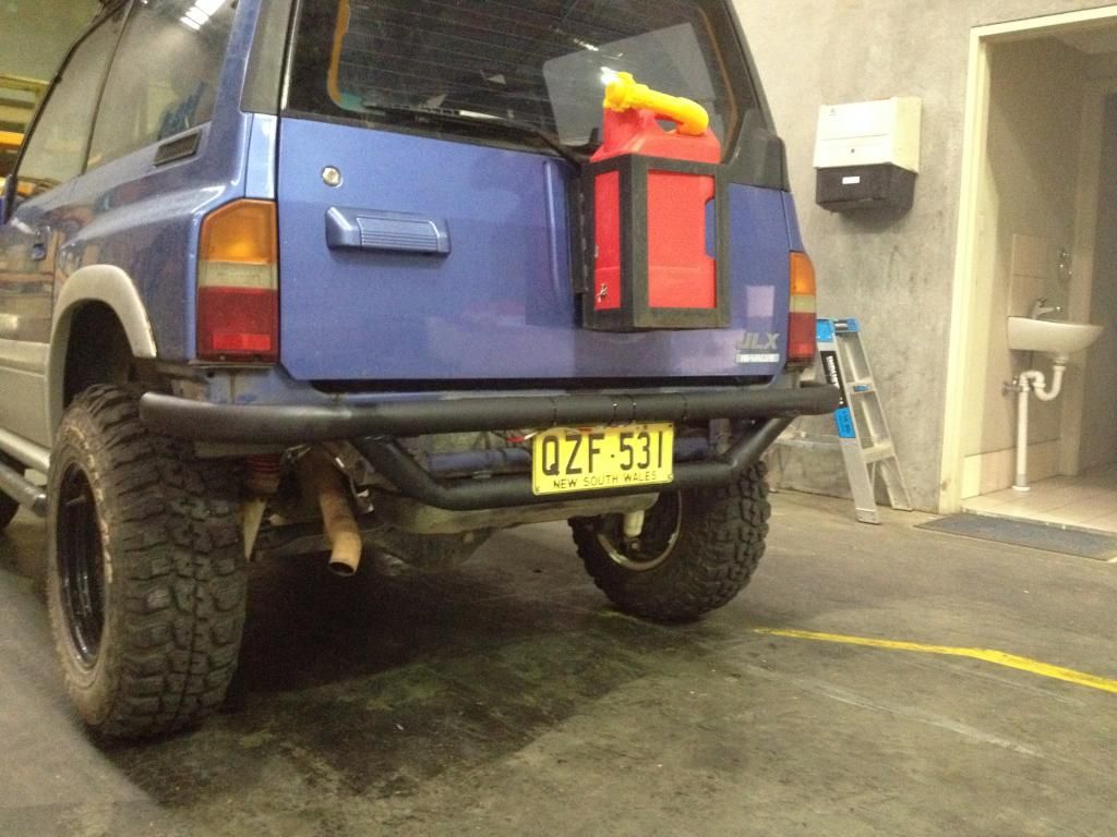

Nice job on the bar I did notice the kinks from the press bender they really aren't much chop.next time try filling the tube with sand and tax some caps on it and it should bend better.
And on the topping of welded recovery points 1 inch of good penetrated weld is capable of lifting a tonne so if it's welded fully it should withstand anything I have them on mine and have recovery many a snatch without fail or hint off.

Yeh ive gone one step further and have a laser cut kit for a proper mandrel bender waiting to be assembled. I just got to but the bullet and buy a $500 die for it but that should get me flawless results :) But ive pretty much made all the bar work i need on my zook already! haha
mmm i do still need to do the recovery points.. and i will have to weld something cause there is no where to bolt anything on with this custom bar

those mudflaps are in adequate can only be a maximum of 240 mm off the ground to the bottom of the mud flaps, awesome build tho
