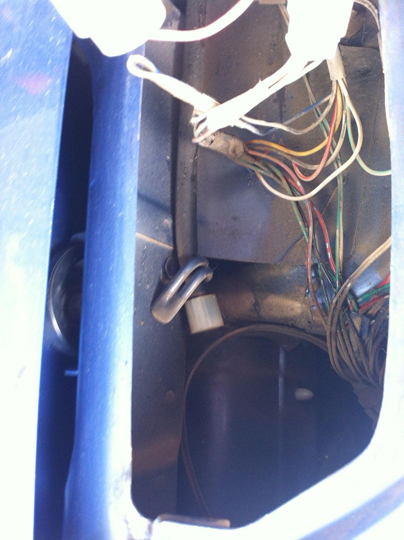

Whilst rebuilding I looked at doing up diff breathers etc for my SWB Vitara.
But it seems either it came standard with extended breathers or someone already installed.
The rear breather runs all the way up behind the left rear tail light and the front goes into the bottom of the charcoal canister for the pollution control.
Or am I seeing this wrong?
Post Posted: Thu Aug 29, 2013 9:47 pm
correct, that is factory fitment on all vitara's. 8)
