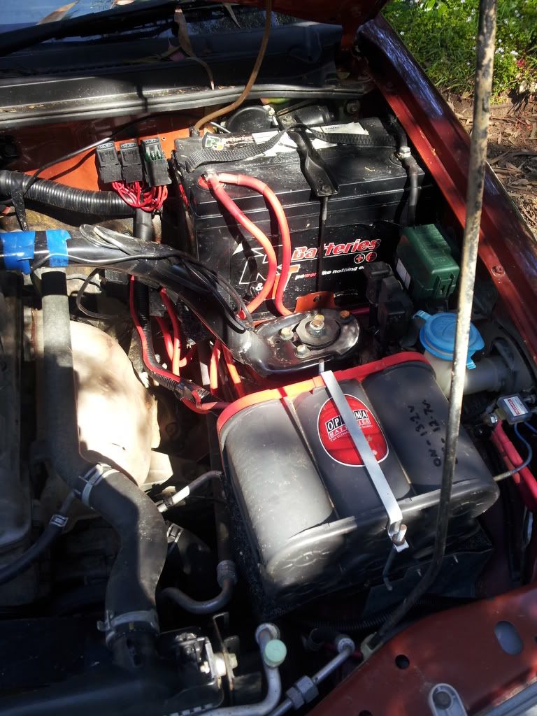

Post Posted: Sun Nov 04, 2012 8:08 am
If you want to locate a battery in the back, the easiers place to put one would be the footwell behind one of the seats. Easy to make a box up and a AGM battery of 110 A/H would fit easy. I know what you mean about the extra weight. I am running a 110 A/H AGM deep cycle and the bastard weighs about 30kg. And then there is the Optimia starting battery and your looking at about 45kg in batterys (and about $600 plus wiring)
I will get a pick now on my phone of my setup that is based around B4T's.
Dave

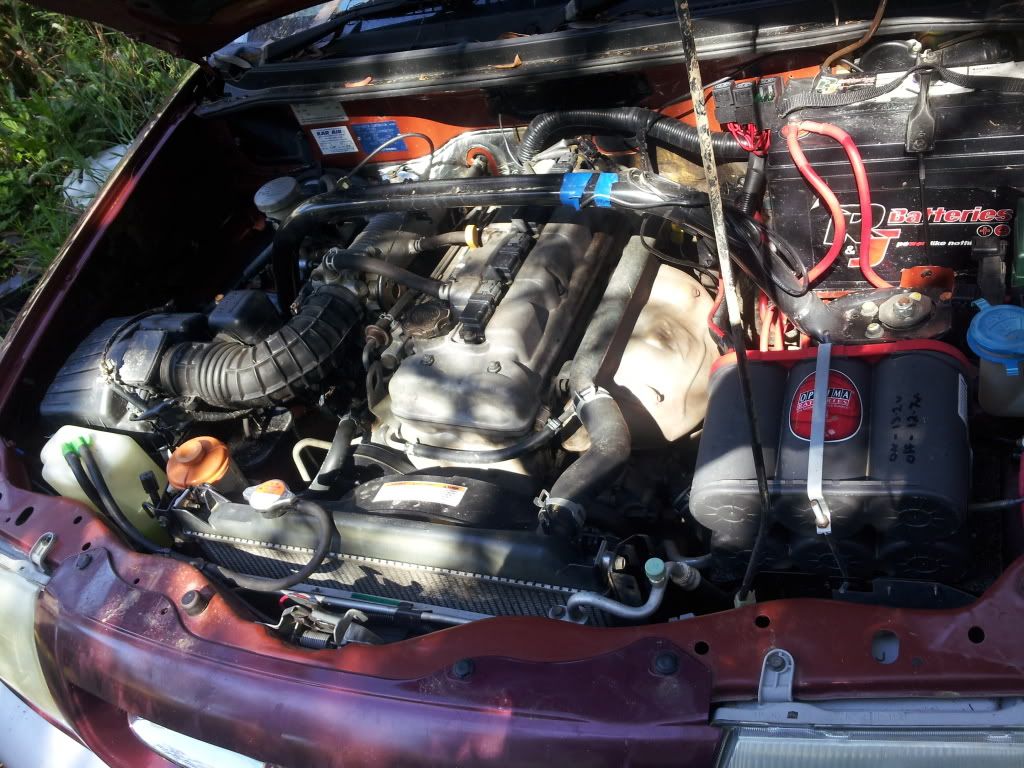

Post Posted: Sun Nov 04, 2012 8:22 am
The overflow bottle had to be relocated to the left and the windscreen washer bottle had to be relocated into the guard with an XL7 washer bottle. Both fairly straight forward mods. The starting battery is the Optima Red Top on its side for clearance and the Deep Cycle is sitting in the stock battery position. It JUST fits only needed to massage the bonnet a tiny bit to stop it rubbing on the earth.
The 3B&S cable coming off the deep cycle runs to the back so I have battery voltage in the boot :D Works a treat but now I have put royce's loom upgrade in, just need B4T to shorted the cable running to the 80amp fuse and it will clean it up a bit.
Dave
Life's short, fiddle with your willy while you can
Joined: Wed Nov 10, 2010 9:18 am
Posts: 1376
Location: Avonsleigh, Victoria
Post Posted: Sun Nov 04, 2012 8:24 am
p.s that dodgy as bitta blue tape holding wires to the strut brace is my spotlight twist and tape switch :lol:
